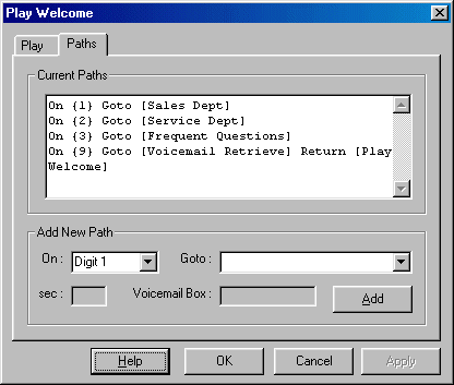

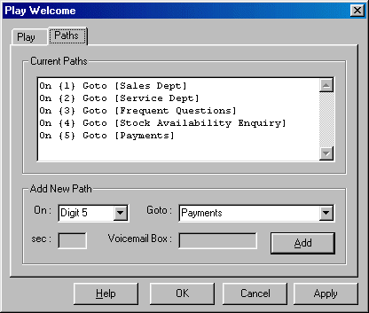

Creating new paths
To create a new path, press the Properties button on the module from which the path will start, and go to the Paths tab.
Paths are specified using the format:
on {Trigger} goto [Module Title]
The text in the Paths window can be edited directly, or you can use the Add New Path help frame.

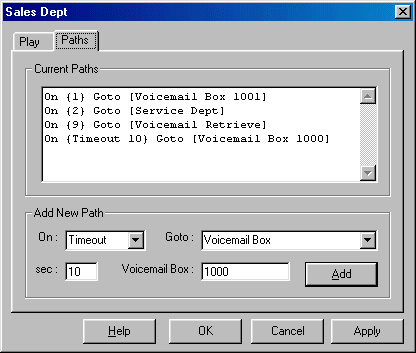

Timeout Paths
A Timeout path will be taken if a caller has not made a selection within the specified number of seconds. A Timeout path with a wait time of zero seconds will be taken immediately after the last sound file in the module has completed playing.
Paths to Voicemail System
Paths can direct the caller to a Voicemail Box, Voicemail Box Menu or Voicemail Retrieve Menu, eg:
When specifying the Voicemail Box as the destination, the Voicemail Box number must be specified as well. make sure that the Voicemail Box specified exists and has been configured using the Voicemail System Manager.
