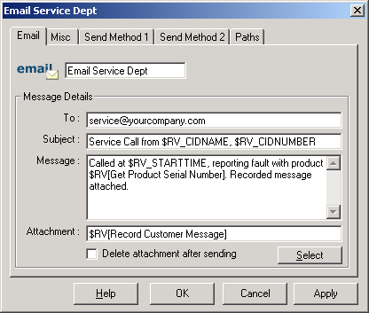

This module will send an Email message.
You can specify the Destination, Title, Message Body and an Attachment File. Result Variables can be used.
Example:
If the message needs to be sent to multiple email addresses the individual addresses must be separated
by semicolons ";" or commas ","
Other information may be set in the Misc tab, including return email address, CC, BCC.

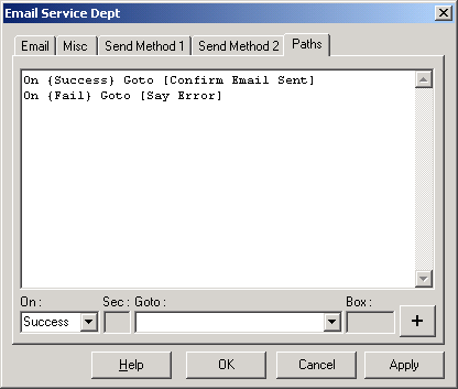

If the email was queued to be sent then the Success path will be taken. If there were problems with queuing the email then the Fail path will be taken. Note that a 'Success' result does not indicate that email was successfully sent out or delivered. A 'Success' result just indicates that the email was queued for sending.
What the above paths do:
on {Success} goto [Confirm Email Sent] |
Go to module "Confirm Email Sent" |
on {Fail} goto [Say Error] |
Go to module "Say Error" |
