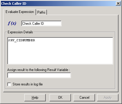

The Evaluate Expression can be used to switch to different parts of the script based on Caller ID. To switch based on the caller's phone number use $RV_CIDNUMBER as the Result Variable to be evaluated :
And when specifying the paths, use the telephone number in the { } section.

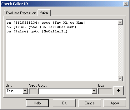

eg: If $RV_CIDNUMBER was used, and you want to handle calls from number 5625551234 in a special way, the path to send all the calls from this number to a particular module would be:
on {5625551234} goto [List Administrator Options]
you could also use:
on {} goto [NoCallerId]
or
on {False} goto [NoCallerId]
both of which will match if CallerID number is blank.
on {True} goto [CallerIdWasSent]
will be taken if CallerID was provided but no specified path explicitly matched the number:

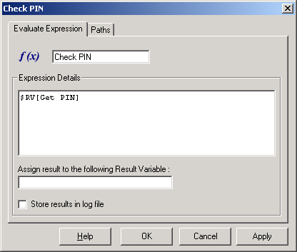

The Evaluate Expression module is used to check the PIN entered in previous Get Number module titled "Get PIN".

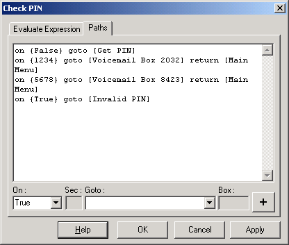

And the paths in this case are defined as:
What do the paths do:
on {False} goto [Get PIN] |
If for some reason no PIN was entered, and $RV[Get PIN] holds no numbers, then goto the Get PIN module |
on {1234} goto [Voicemail Box 2032] return [Main Menu] |
If the entered PIN was 1234 then go to the Voicemail box number 2032, and then when the caller has finished leaving the message return the caller to the Main Menu module |
on {5678} goto [Voicemail Box 8423] return [Main Menu] |
If the entered PIN was 5678 then go to the Voicemail box number 8423, and then when the caller has finished leaving the message return the caller to the Main Menu module |
on {True} goto [Invalid PIN] |
A PIN was entered and $RV[Get PIN] does hold some entered number, but that number does not match exactly any of the paths specified. Go to the Invalid PIN module. |
It is a good idea to always specify the TRUE and FALSE paths, since VoiceGuide will hang up the call if it cannot find a valid path to go to the next module.

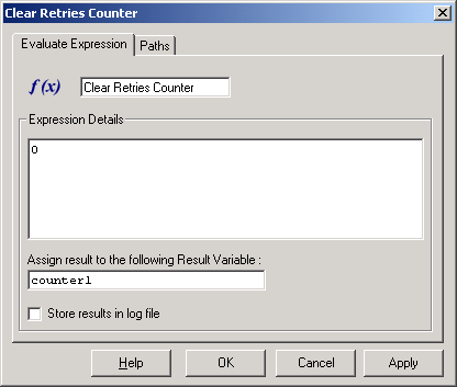

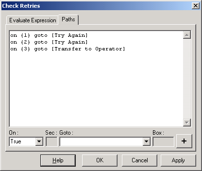

Evaluate Expression module can be used to implement a counter to check the number of times the caller goes though certain parts of the call flow. This example demonstrates how a counter can be implemented.
A user defined Result Variable is created and its value is set to zero. Note that as the Result Variable was assigned a value of 0, the 'False' path will be taken from this module.

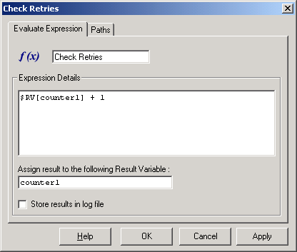

The counter in incremented by retrieving the current value of the user defined Result Variable, adding 1 to this current value, and then saving the result back into the user defined Result Variable.
The value saved by this Evaluate Expression module is then used in the Paths section to determine the next module the script should branch to.
