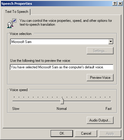

VoiceGuide v5 / v6
For VoiceGuide v5/v6 the default SAPI TTS voice can be set using the Speech applet from the Windows Control Panel:
If the Speech applet above cannot be seen in the Control Panel then it can be found in this location:
C:\Program Files\Common Files\Microsoft Shared\Speech\sapi.cpl
