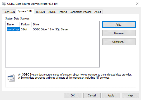

The ODBC Data Source Administrator looks like this:
Select the 'System DSN' tab.
The ODBC DSNs need to be created as a "SYSTEM" type DSNs in order to allow them to be accessible from Windows Services.
(VoiceGuide runs as a Windows Service),

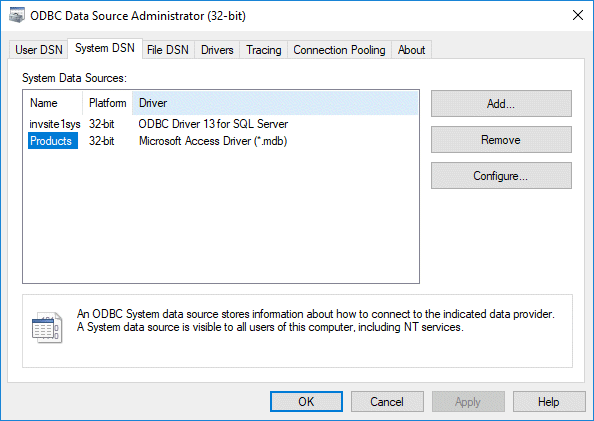

After setting up the new ODBC Data Source, it will appear in the list of System Data Sources:
This ODBC Data Source is now ready to be used.
