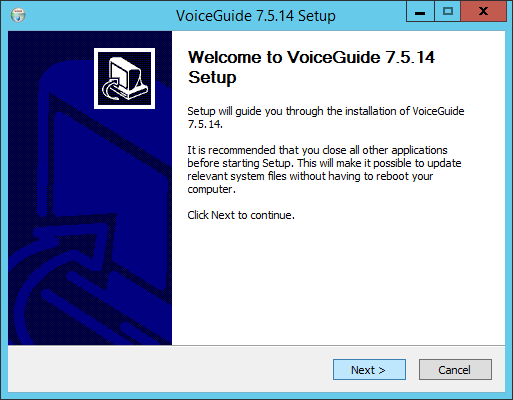

The VoiceGuide installer will then start:

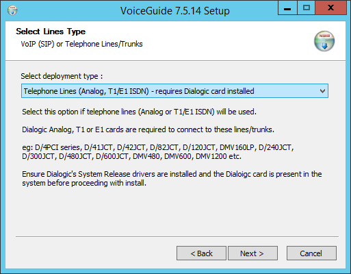

The Deployment Type needs to be set to:
Analog, T1/E1 ISDN
This will instruct VoiceGuide installer to set up configuration files for Analog/T1/E1 based systems that use traditional Dialogic cards:

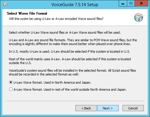

Then select whether by default the system should use ULaw or Alaw format when recording files, and which format 'system sound files' should VoiceGuide use:
VoiceGuide will play back many different format sound files, and this selection will not restrict what sound files can be played, but this selection decides whether ULaw or Alaw format will be used when recording. Matching VoiceGuide's record sound format with the format used by telephone service provider results in best quality sound recordings.
Also, playing sound files in the same format as what the telephone service provider uses means that the files will not need to be transcoded or resampled when sent over the telephone service provider's network. This helps in achieving the best possible quality sound playback.

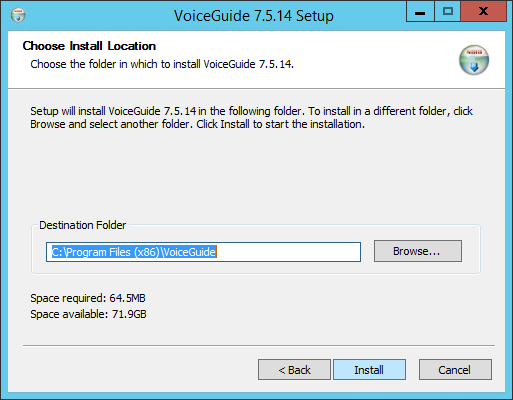

Next select the directory into which VoiceGuide should be installed.
If you select a directory other then the default directory then the VoiceGuide's Config.xml setting that specifies the callflow that is to be used on each channel will need to be updated with that directory details. (and VoiceGuide service restarted afterwards).

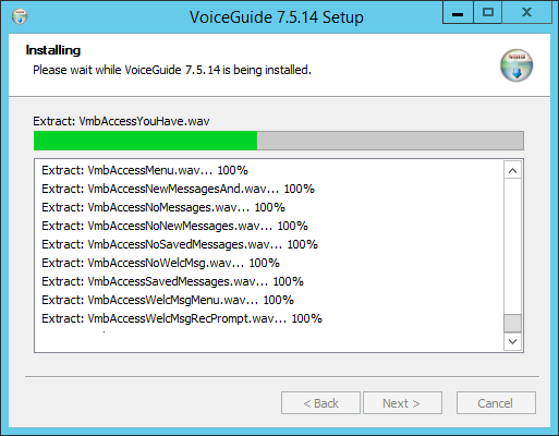

The files will then be installed:

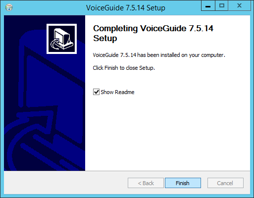

When installation is complete the final screen will appear:

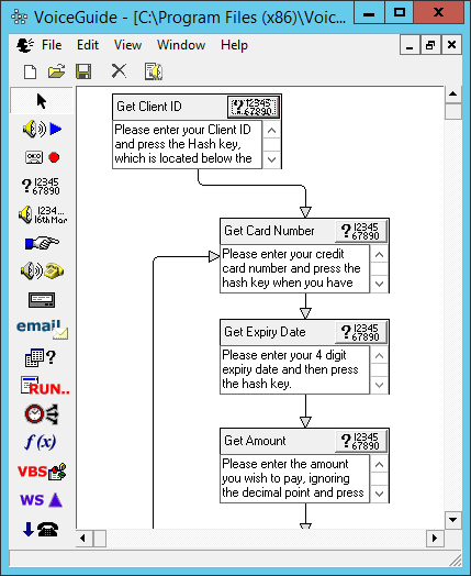

And the Script Designer will be started, loading the default demo callflow.
(The callflows/scripts to use are set in the Config.xml file):

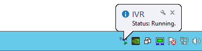

The IVR icon will also appear in the icon tray at the bottom right of the screen.
Once the VoiceGuide Service starts a still green arrow will show on that icon:

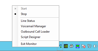

Clicking VoiceGuide's IVR tray icon shows a context menu that allows user to control the VoiceGuide service, and start various VoiceGuide applications:

When using VoiceGuide v7.x it is best if sound files used are uLaw or ALaw encoded (both 8kHz, 8 bit, Mono, in .WAV file).
uLaw or ALaw format is selected at install time.
Systems located in North America and Japan should use the uLaw format.
Systems located in the rest of the world use ALaw format.
These are the two formats used by telephone companies to transmit voice over the traditional Analog and T1/E1 connections, and using this sound format will result in little or no distortion of the sound when it is transmitted over the telephone service provider's network.
