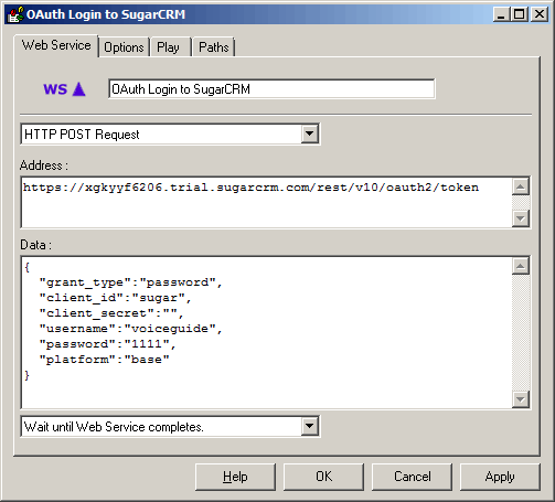

Voiceguide script would use a Web Service module to issue a POST requires to the /oauth2/token REST API function, and provide the required data in JSON format.
The https address to POST to would be something like this:
With the YOURDOMAIN part replaced with the domain name/IP of your SugarCRM installation.
The Data to be POSTed would be something like this:
With MYUSERNAME and MYPASSWORD replaced with a valid user/pass defined on your SugarCRM system.
Here is a screenshot of the Web Service module configuration screen:
When this module is ran SugarCRM wil return data that will be saved into Result Variables. The OAuth2 access token will be saved in $RV[access_token]

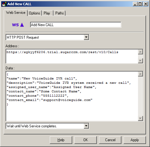

To add a new CALL object into SugarCRM a POST would be made to his https address:
With the following data:
"name":"New VoiceGuide IVR call",
"description":"VoiceGuide IVR system received a new call",
"assigned_user_name":"Assigned User Name",
"contact_name":"Some Contact Name",

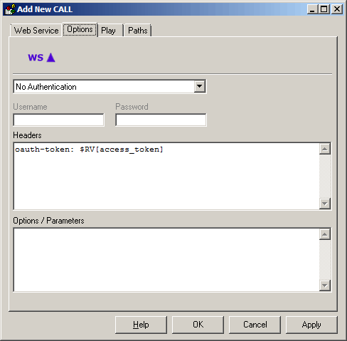

And the OAuth2 token would be set in the Headers options like this:
oauth-token: $RV[access_token]
Here are the screenshots showing module configuration:
