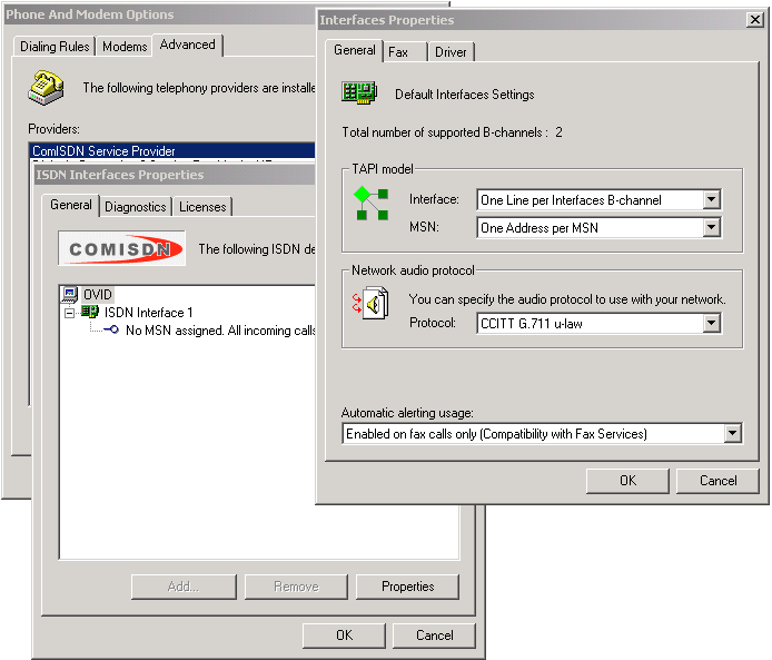

Configuring ComISDN
The ComISDN TSP can be configuration window is accessed using:
Open Start -> Settings -> Control Panel then click "Phone and Modem Options" or "Telephony", and then under "Advanced" or "Telephony Drivers", select "ComISDN Service Provider" and click "Configure".
The ISDN Interface Properties window will appear:
The main setting that needs to be confirmed as having been correctly set is the "Network audio protocol". If not set correctly the sound played will sound distorted.
To set the Network Audio Protocol select the Computer (root) and then click "Properties".
By default, ComISDN will use "u-Law" if it detected that the version of Windows installed is a US, Canadian or Japan one. For all other countries, it will use "A-Law".
If Windows has not been configured with the correct country setting then it is possible that this setting is incorrect and will need to be set manually. please ensure that it is set to "u-Law" if you are located in US, Canada or Japan, and set it to "A-Law" if you are located in other countries. It may also want to confirm with the telephone company or PBX supplier which protocol should be used - or just try them both and see which one sounds better.

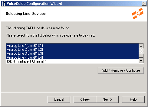

Running the Setup Wizard
The Setup Wizard will discover all the TAPI capable telephony devices and will allow you to select which devices you would like to use with VoiceGuide:
Next you need to select the Scripts which will be used by VoiceGuide when an incoming call arrives on the selected devices. To begin with we'd recommend you select the demonstration script in VoiceGuide's "/Scripts/Credit Card Payment" directory:
When Setup Wizard configuration has completed you should now be able to start VoiceGuide and call into the system to hear it answer the call and lead you through the selected VoiceGuide script.
