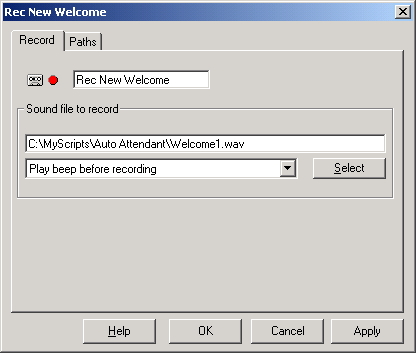

Following can be specified in the ‘Sound File to Record’ text box:
Full filename of the destination file
Recording will be made into the specified file. If a file with this name exists already then it will be overwritten. -
Just the directory into which the recordings are to be placed
A filename will be generated and the recording will be placed in the specified directory.
The directory name must finish with a “\” -
Leave the entry blank
A filename will be generated and the recording will be placed in the script’s directory

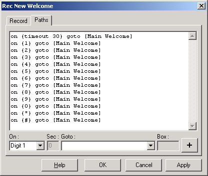

The Timeout path is used to specify the maximum length of recording.
eg: the screenshot below of the module's paths tab shows that that module a "timeout 30" path.
If recording length reaches 30 seconds then recording will be stopped and that path will be taken.
Also, if the caller presses any of the keys that have paths defined for it, the recording will terminate and the caller will be sent to the module specified in the path (in this case all paths lead back to the Main Welcome module.

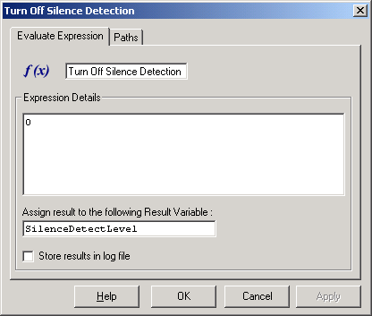

The silence detection settings can be set from within the script as well, by assigning values to Result Variables SilenceDetectLevel and SilenceDetectLength
This can be done using the Evaluate Expression module, or setting them in any other way that Result Variables can be set.
eg. To disable silence detection using the Evaluate Expression module:
