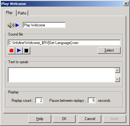

Result Variables can be used when specifying the sound file to be played. In the example below the file played will be different depending on what selection the caller made in the 'Get Language' module.
Multiple sound files can be selected to be played by separating the successive files by commas. eg:
prompts\1.wav, prompts\2.wav
would result in two files from the script's prompts subdirectory being played (1.wav and 2.wav) one after another.
If the sound files are specified without a full path then VoiceGuide will search for the sound files in the script's directory, or in a script's \voice\ subdirectory (if it exists).

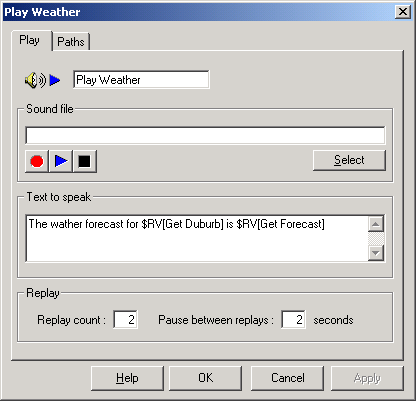

Text-To-Speech (TTS)
The text entered in the "Text to speak" box will be spoken. XML tags can be used within the specified text. For full details on the XML tags which can be used please refer your TTS engine's reference.

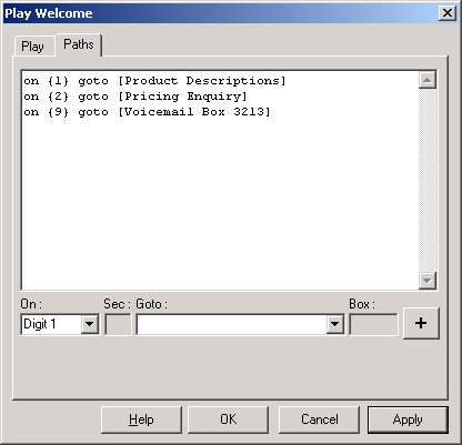

Paths
Paths specify which module the caller will go to if a matching response is made by the caller. eg:
A Timeout path is taken if no key has been pressed within the specified number of seconds after the last replay of sound file(s) has completed. If no Timeout path is specified and no selection is made within 10 seconds of the last message replay finishing, VoiceGuide will hang up the call.
