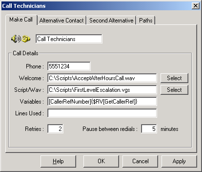

In the properties page screen capture above we see that the caller's problem reference number is being passed to the FirstLevelEscalation.vgs script. The reference number would have been generated previously in module CallerRef, and $RV[CallerRef] will be replaced with the actual reference number when the call is queued. The reference number can then be accessed using $RV[CallerRefNumber] in the FirstLevelEscalation.vgs script.
