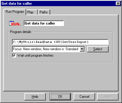

Run Program Module
This module will run the specified program. Result Variables can be used when specifying the program's name and the parameters passed to the program.
Run Program Tab
The Program name and parameters passed to the program are specified here.

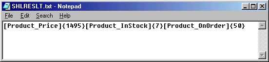

A custom written utility ReadData.exe to retrieve information about a product has been written and the system has a Get Number Sequence module called Get Data Type which is used to ask caller to select what data is to be retrieved. The ReadData.exe is then called with the information entered in Get Data Type passed as a parameter.
Result File is then be used to return the retrieved data. ReadData.exe writes the following data into the file:
The above will create 3 new Result Variables in VoiceGuide, which can be accessed using:
$RV[Product_Price]
$RV[Product_InStock]
$RV[Product_OnOrder]
whose values are:
1495
7
50
respectively. These Result Variables can then be used is Say Numbers modules to speak out this information to the caller.
