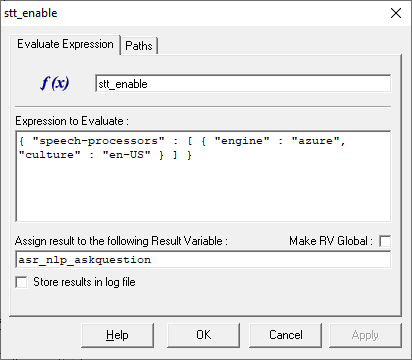

The Result Variable must contain a JSON formatted string that specifies which engine and options are to be used in that module. eg:
{ "speech-processors" : [ { "engine" : "azure", "culture" : "en-US" } ] }
The above value would enable Azure STT engine in the corresponding module.
eg: This is how an Evaluate Expression module can be used to enable Azure STT in module titled: askquestion
