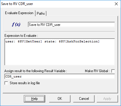

Alternatively you can set: $RV[CDR_amaflags] or $RV[CDR_user] to hold data of your choice, and these $RVs are then saved in CDR. See below:
From https://www.voiceguide.com/vghelp/source/html/log_cdrs.htm :
Contents of $RV[CDR_amaflags] will be placed in the 16th CDR field.
Contents of $RV[CDR_user] will be placed in the 17th CDR field.
