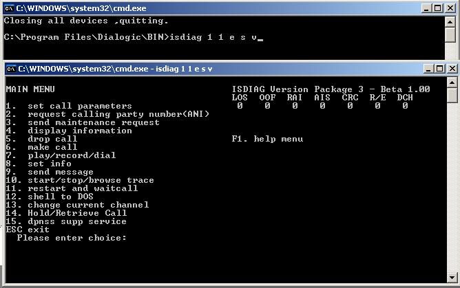

huuphuc Report post Posted 03/05/2008 08:47 AM Dear Sir I had run ISDIAG, no error but not receive signal from line E1. Please help me. My Bpx: Alcaltel Ommi OXO Protocol: QSIG Thanks Share this post Link to post
SupportTeam Report post Posted 03/05/2008 11:07 AM What does ISDIAG show? Please post some screenshots. We also offer an installation service where we can log into the system and do the Dialogic card testing and installation. Please contact sales@voiceguide.com for pricing. Share this post Link to post
huuphuc Report post Posted 03/10/2008 01:27 AM Dear Sir This is file .jpg. Please help me. Thanks Share this post Link to post
SupportTeam Report post Posted 03/10/2008 02:23 AM Screenshot shows the D channel on the ISDN line is OK. You should now be able to try placing some calls into the system and use ISDIAG to answer the call. You could also start the ISDN level trace. It's best to start a trace then place a call into the system and then answer the cal and then hangup. Then save the ISDN trace and have a look at it (or post it here) to make sure all is OK. Once ISDIAG shows all is OK you can start VoiceGuide and start using VoiceGuide to receive and make calls. Share this post Link to post

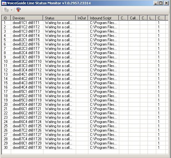

huuphuc Report post Posted 03/11/2008 07:01 AM [Did you try answering the incoming call using ISDIAG?] Yes, i do. [When you just start VoiceGuide v7 now and place a call into the system what happens?] No happen. 0311_ktTel.txt Voiceguide.bmp Share this post Link to post
SupportTeam Report post Posted 03/11/2008 07:10 AM Looking at the System Status screenshot we can see that you have not changed VoiceGuide's Config.xml file to match the Dialogic card which you are using. VoiceGuide by default installs the Config.xml file for a 4 line analog card, and you want the 30 line ISDN version of the Config.xml Do this: 1. Stop VoiceGuide. 2. Go to VoiceGuide's \Config\ subdirectory. 3. Rename "Sample Config for 30 ports using one E1 ISDN.xml" to "Config.xml" (overwrite previous Config.xml) 4. Start VoiceGuide. Make another call into system after VoiceGuide is started. post ktTel trace capturing incoming call. Share this post Link to post

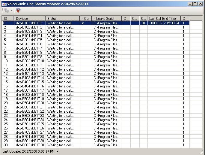

huuphuc Report post Posted 03/15/2008 03:03 AM Dear Sir I had receive incoming call, but i don't hear sound. Please help me. 0212_ktTel.txt 0215_ktTel.txt Share this post Link to post
SupportTeam Report post Posted 03/15/2008 08:20 PM Trace shows VoiceGuide is issuing commands for the Dialogic card to Accept and Answer the call, but immediately after issuing the Answer command the Dialogic drivers respond that the call is DISCONNECTED There is really not much that we can do about this. The card which you are trying to use is old and the drivers have already been discontinued, so this product is not supported by Dialogic any more. Recommend you change to a D/300JCT card and use the current release SR6.0 drivers. 0212: 133050.279 1368 002 ev GCEV_DETECTED crn=0x0=0 {2:crn_set} 133050.279 1368 002 CtEventProcess (from store) idx=32, iDev=2, lEvtType=2084, pEvtData=0x6d36f38, lEvtDataLen=28, (store: evinque=0, maxever=1) 133050.279 1368 002 ev GCEV_OFFERED crn=0x2008001=33587201 (ktTel_SR60 v7.0.5, Feb 26 2008 16:17:15) {2:crn_set} 133050.279 1368 002 calling CIPStateMachine_NullGcevOffered next 133050.279 1368 002 raising LINECALLSTATE_OFFERING next 133050.279 1368 002 CTelProxy::Event_CallState m_pTelProxyClient=0078146C 133050.279 1368 002 raise CallState LINECALLSTATE_OFFERING 133050.340 1368 002 calling OnOffered_GetCallerID next 133050.340 1368 002 OnOffered_GetCallerID start (with CallerID report) 133050.340 1368 002 OnOffered_GetCallerID gc_GetCRN: crn=0x2008001=33587201 {2:crn_set} 133050.350 1368 002 could not retrieve CALLNAME 133050.350 1368 002 CTelProxy::Event_CallerId begin. name=, nbr=123, dnis=102 133050.360 1368 002 raise CallerId 133050.390 1368 002 fn LineAnswerCall(sXMLOptions=[]) 133050.400 1368 002 gc_AcceptCall crn=0x2008001=33587201 133050.400 1368 002 CTelProxy::Event_CallerId end 133050.400 1368 002 CtEventProcess (from store) idx=33, iDev=2, lEvtType=2052, pEvtData=0x6d36f68, lEvtDataLen=28, (store: evinque=0, maxever=1) 133050.400 1368 002 ev GCEV_ACCEPT crn=02008001=33587201 133050.400 1368 002 CTelProxy::Event_CallState m_pTelProxyClient=0078146C 133050.400 1368 002 raise CallState LINECALLSTATE_ACCEPTED 133050.400 1368 002 IssueAnswerCallAfterReceivingAcceptedEvent=true 133050.400 1368 002 gc_AnswerCall crn=02008001=33587201 133050.430 1368 002 CtEventProcess (from store) idx=34, iDev=2, lEvtType=2086, pEvtData=0x6d36f98, lEvtDataLen=28, (store: evinque=0, maxever=1) 133050.430 1368 002 ev GCEV_DISCONNECTED crn=02008001=33587201 133050.440 1368 002 GCEV_DISCONNECTED : gcValue=68(0x44), gcMsg=[invalid parameter], ccLibId=2, ccLibName=[GC_ISDN_LIB], ccValue=0x38a, ccMsg=[bad input parameter], additionalInfo=[] 133050.440 1368 002 raise Dialogic GCEV_DISCONNECTED 2086 (2086 0 0 ) 0215: 094901.654 2540 002 ev GCEV_DETECTED crn=0x0=0 {2:crn_set} 094901.654 2540 002 CtEventProcess (from store) idx=32, iDev=2, lEvtType=2084, pEvtData=0x6d36f38, lEvtDataLen=28, (store: evinque=0, maxever=1) 094901.654 2540 002 ev GCEV_OFFERED crn=0x200803f=33587263 (ktTel_SR60 v7.0.5, Feb 26 2008 16:17:15) {2:crn_set} 094901.654 2540 002 calling CIPStateMachine_NullGcevOffered next 094901.654 2540 002 raising LINECALLSTATE_OFFERING next 094901.654 2540 002 CTelProxy::Event_CallState m_pTelProxyClient=0078146C 094901.664 2540 002 raise CallState LINECALLSTATE_OFFERING 094901.724 2540 002 calling OnOffered_GetCallerID next 094901.724 2540 002 OnOffered_GetCallerID start (with CallerID report) 094901.724 2540 002 OnOffered_GetCallerID gc_GetCRN: crn=0x200803f=33587263 {2:crn_set} 094901.724 2540 002 could not retrieve CALLNAME 094901.724 2540 002 CTelProxy::Event_CallerId begin. name=, nbr=123, dnis=300 094901.724 2540 002 raise CallerId 094901.764 2540 002 fn LineAnswerCall(sXMLOptions=[]) 094901.774 2540 002 gc_AcceptCall crn=0x200803f=33587263 094901.774 2540 002 CTelProxy::Event_CallerId end 094901.795 2540 002 CtEventProcess (from store) idx=33, iDev=2, lEvtType=2052, pEvtData=0x6d36f68, lEvtDataLen=28, (store: evinque=0, maxever=1) 094901.795 2540 002 ev GCEV_ACCEPT crn=0200803F=33587263 094901.795 2540 002 CTelProxy::Event_CallState m_pTelProxyClient=0078146C 094901.795 2540 002 raise CallState LINECALLSTATE_ACCEPTED 094901.795 2540 002 IssueAnswerCallAfterReceivingAcceptedEvent=true 094901.795 2540 002 gc_AnswerCall crn=0200803F=33587263 094901.815 2540 002 CtEventProcess (from store) idx=34, iDev=2, lEvtType=2086, pEvtData=0x6d36f98, lEvtDataLen=28, (store: evinque=0, maxever=1) 094901.815 2540 002 ev GCEV_DISCONNECTED crn=0200803F=33587263 094901.815 2540 002 GCEV_DISCONNECTED : gcValue=68(0x44), gcMsg=[invalid parameter], ccLibId=2, ccLibName=[GC_ISDN_LIB], ccValue=0x38a, ccMsg=[bad input parameter], additionalInfo=[] 094901.815 2540 002 raise Dialogic GCEV_DISCONNECTED 2086 (2086 0 0 ) 094901.815 2540 002 CTelProxy::Event_CallState m_pTelProxyClient=0078146C 094901.815 2540 002 raise CallState LINECALLSTATE_DISCONNECTED Share this post Link to post
