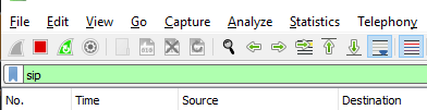

Tracing SIP Messages
WireShark : https://www.wireshark.org can be used to confirm that SIP packets are arriving at VoiceGuide/HMP system.
To isolate SIP traffic the following should be specified in WireShark's Filter text box:
sip
To isolate SIP and RTP traffic the following should be specified in WireShark's Filter text box:
sip || rtp
To save the isolated traces go to WireShark's File->Export Specified Packets menu and save the displayed packets as .pcapng format.
Please ensure all posted files are .ZIPed up before posting.

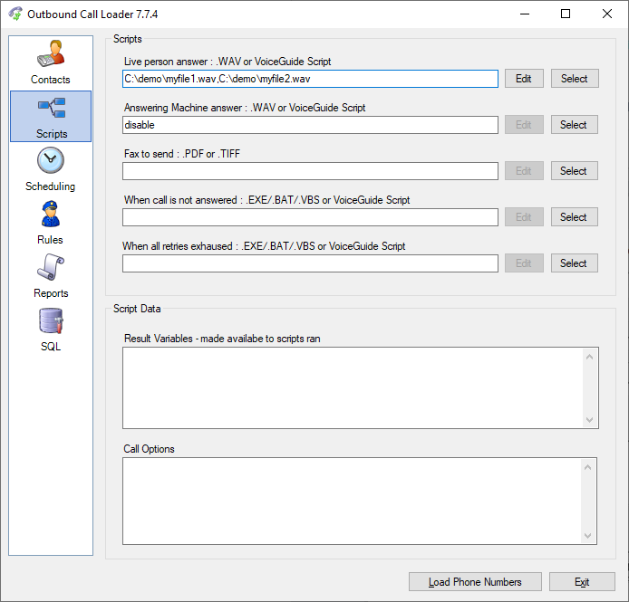

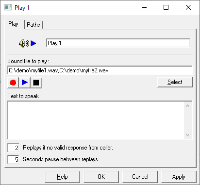

in any module in VoiceGuide script it's be done like this:
and similar in the outbound call loader:

Are you adding files using the "Select" button? That will only select one file and populate the 'sound file' text box with that file.
To specify multiple files to be played you need to type the paths/filenames into the text box.

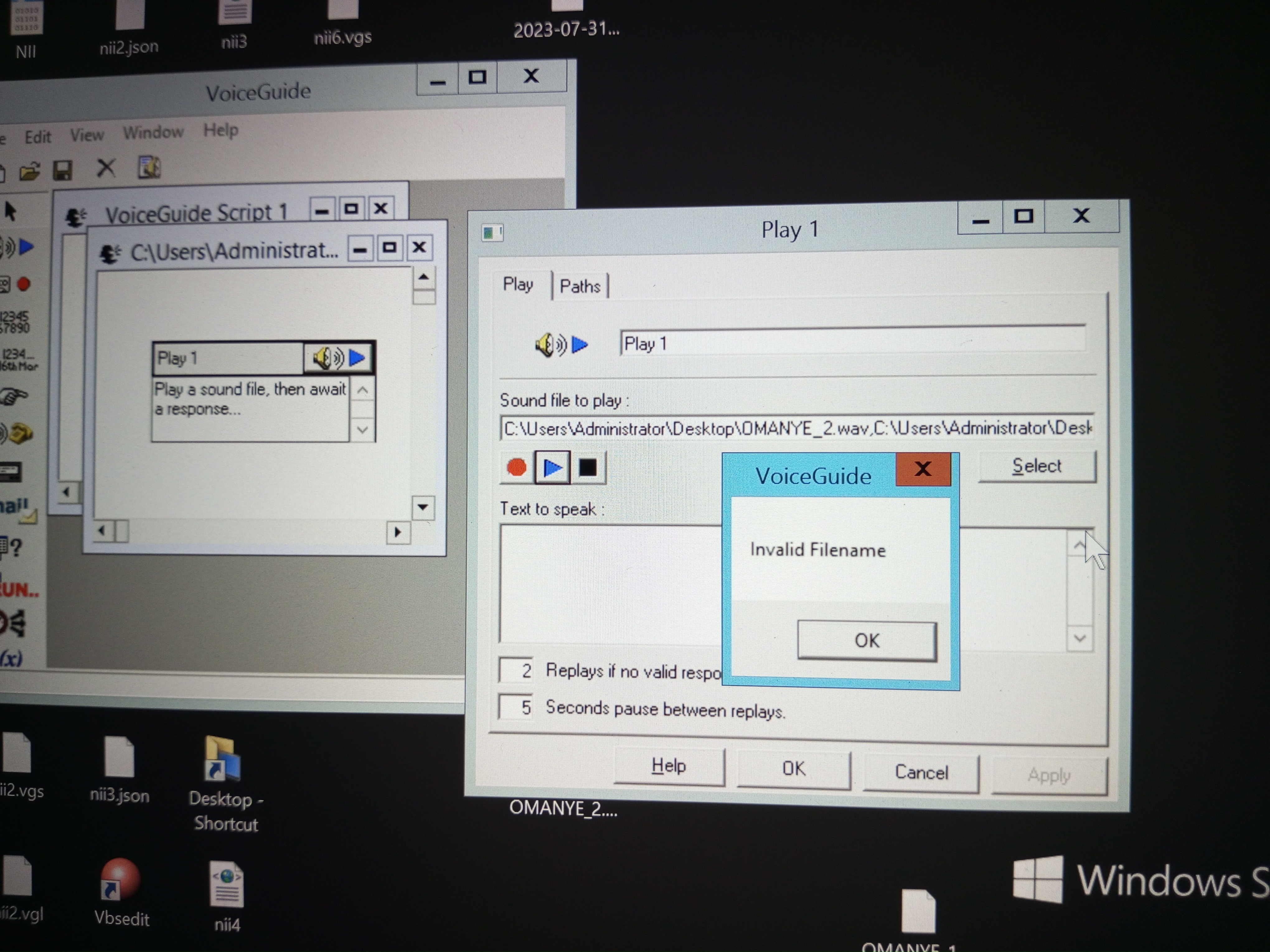

 hi support,
am getting "valid file name "     per the above. i.e. typing the file name or path....
what do we do next ...
thanks
Can you please post some screenshots or a screen video capture so that we can see how you are using the software.

HI,
please see attached .
Are you trying to play over the local speakers of headphones the list of comma delimited sound files specified as the sound files to be used by that 'Play' module?
What button did you press immediately before the "Invalid Filename" error box popped up?
playing of local speakers , and  i pressed the play button on the play module...
thanks
That play button will not play back a list of sound files. The "Record", "Play" and "Select" buttons are meant to be used for easy selection and recording or verification of contents of single files only.
so,  how do we  playing multiple sound files ... please
thanks
There is no way to play back concatenated sound files in the script editor. Best way to test playback in that case is to just make a call into the system. That way you will hear the sound files played in exactly same way as the IVR user will.

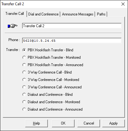

1, how can I make or get an IVR to play for an incoming call ..       achiveing that, do i need to make the VG an extension in the PBX ?
2,how do i use call transfer to ,  to bringss calls from a sip server through the VG to  the teleco sip trunk.
thanks
Easiest way is to just call the VoiceGude's IP address direct from an IP phone.
from https://www.voiceguide.com/vghelp/source/html/install_v7_dialogichmp.htm :
You would use the Transfer Call module.
Please see: https://www.voiceguide.com/vghelp/source/html/modxfer.htm
how to get multiple sound to play .....
Just specify the multiple sound files one after another with a comma between each filename. When you call into the system the files will play. They will not play in the script editor, but will play one after another during the actual call.
hi support ,
on the call transfer , i.e. SIP refer transfer ,     can you show an example how his done, after going the  he pointed resource,  my thoughts--->   Sip Server,  send calls to VG (via Hookflash blind)..  ? where do i input the IP/url of the destination sip trunck that receives the call.
thanks
