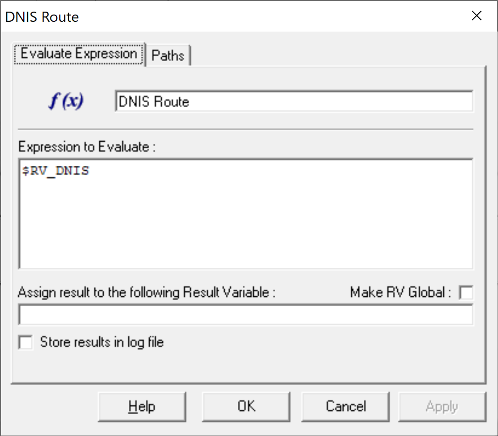

This number is accessible in VoiceGuide script using the $RV_DNIS variable. (see list of system variables here: https://www.voiceguide.com/vghelp/source/html/resultvariables.htm )

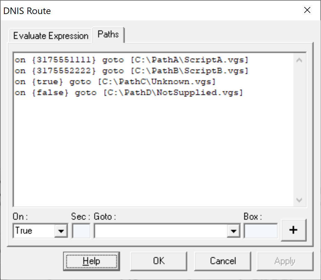

So the script that first answers the call can look at $RV_DNIS and then goto other scripts depending on $RV_DNIS value.

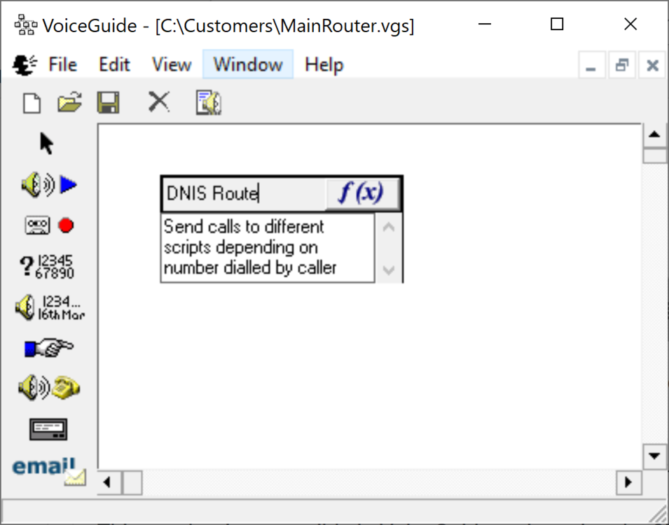

This routing script can consist of just one Evaluate Expression module, but if more advanced routing is needed then a Run Script module can be used instead.
See the "MainRouter.vg" script below (open the .vgs script in VoiceGuide's Script Editor)
