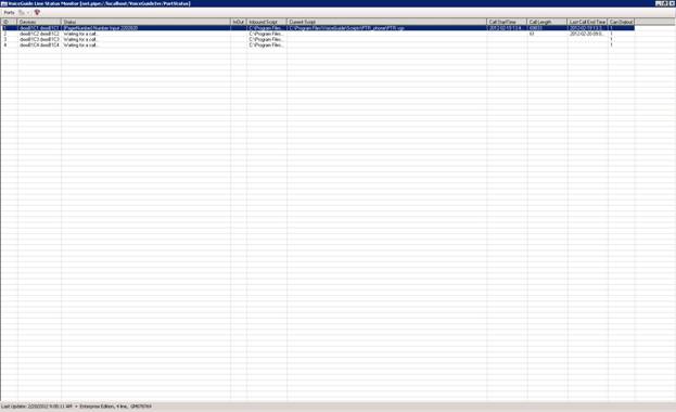

Any thoughts on why the call on device dxxB1C1 hangs on the PagerNumber module?
What can be done to prevent this?

The image of the Line Status Monitor (attached in my first post) is very blurry for some reason, but I was trying to show that for device dxxxB1C1 on row 1, the status is set to [PagerNumber] Number Input 2202820, and the call length is set to about 68011.
Do you know why the call length would be so long, and why it doesn't eventually hang up to free up the line?

The issue is that the call doesn't hangup and keeps the line busy. When I say "hangs on the PagerNumber module", I meant the line never hangs up, and attempts to call it return a busy signal. Also, when looking at the line status monitor, I see the call length is set to a very large number, i.e. 68011.
Can you give us a timestamp?
It happened on 9/19 sometime before 3:30 PM EST, and again on 2/20 sometime before 5:30 PM EST. I can't be sure exactly when, since the only symptoms I see are the high value for call length in the line status monitor and a busy line. If you could help me find that originating call I would be very grateful.
At some point on 9/19, the first line (device dxxxB1C1 on row 1) returned only a busy signal. In order to get the timestamp you're looking for, is it feasible for you to identify the last call received on that line? On 2/20, both lines returned busy signals so it may be easier to identify there.
The call start time is displayed in the line status. The screenshot posted is too small to read any information from it though...

You should also look into what other programs are overloading this system.

The good news is, the new version (7.3.0_120222) appears to fix the ‘two rapid RINGs’ situation, so thank you there.
OK, thanks for letting us know this issue is now fixed.
takes the fail path when TaskCount_RowCount is 0
The "Fail" path will be taken if the database query returns no rows.
Please see the "Paths" section of the Help file entry on the Database Query module: http://www.voiceguide.com/vghelp/source/html/moddbquery.htm
And in the script that you attach we see that the script is already going to different modules depending on whether the database query module does retrieve any data from database or not.
eg: in module [userID] we see paths:
on {success} goto [userID Found]
on {fail} goto [userID Missing]
looking through a frw other modules we note that in module [TaskCount] we see paths:
on {success} goto [HasTask]
on {fail} goto [TaskCount]
the on {fail} goto [TaskCount] path sets up an infinite loop. This path should be deleted.
If you would like for script to proceed to next module regardless of whether the database query module has retrieved any data or not then you will need to have both "on {success} ..." and "on {fail} ... " paths pointing to that next module.
Transitions between modules take longer than they did in the previous version (6.0.0.3391)
v7 has slightly higher system requirements then v6. Do you have sufficient RAM in system to run Microsoft's .NET ?
Please start a new topic indicating what type of system you are using (CPU/RAM/Windows version etc.) and if anything else is running on this system at the same time, and we can then better answer any questions on this. A module transition should take very little time (a few milliseconds at most).
This topic is now closed to further replies.
