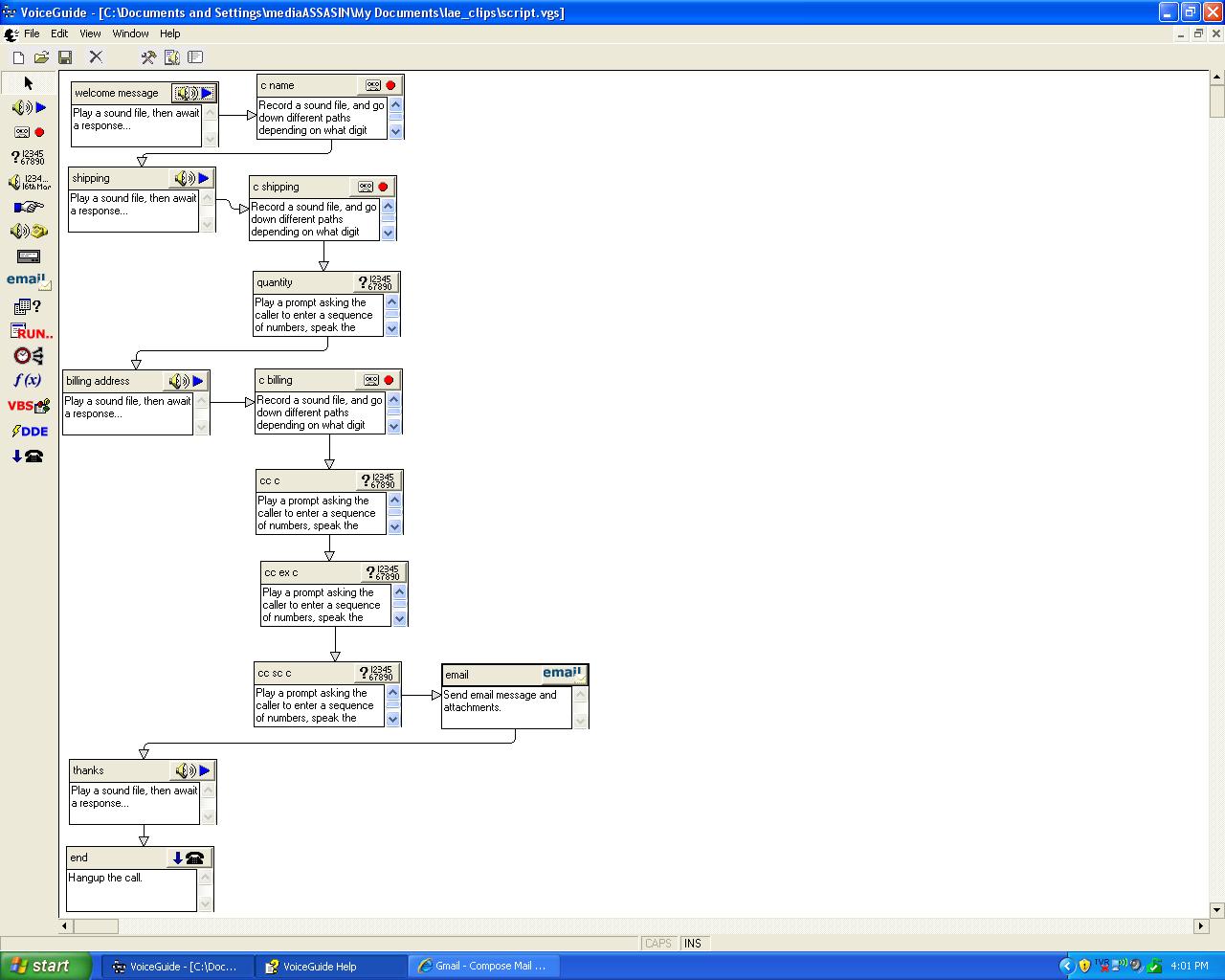

I've built the script out already, i've attached a screen shot of it.

We can help out with the script as well if you would like to post your .vgs script file here. We can then check if it is set up to correct attach the recorded sound files etc.
