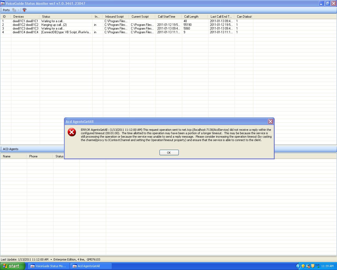

I have a problem with an IVR.
When one user access uses the system, 3 lines are activated automatically by the same user.
When the user finish the call, there are occasions that the same one never hang up, and I have found called with 88,400 seconds of duration.
When the user finish the call, the call isn`t really finished. So I have discovered calls with 88,400 seconds long.
That is to say, the system have troubles to end each call, and the lines are always busy.
Thank you,

This is the error, I did all you told me and i have the same problem again
Please .ZIP up and post the vgEngine and ktTel traces from 12th January. We can then see what is happening on this system.

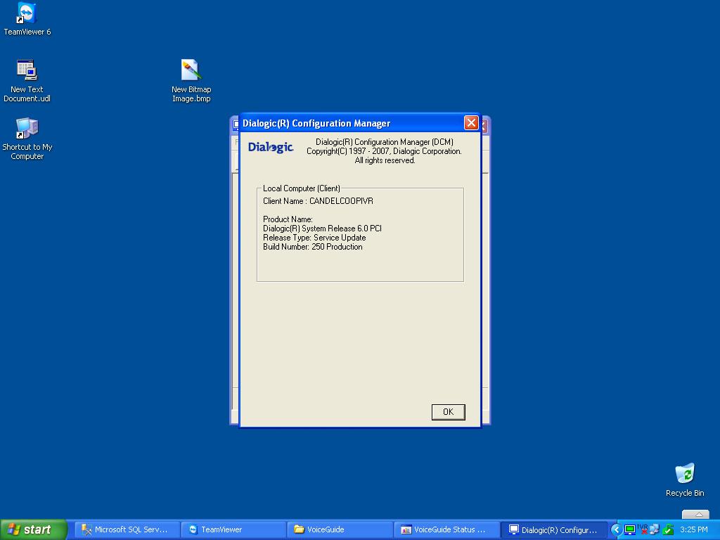

Which version of Dialogic drivers do you have installed on your system? Which Service Update version?
6.0
I don't not what is this
Please open the Dialogic Configuration manager (DCM) then open the "Help"->"About..." screen.
This should show you the service update version. You can post a screenshot if you'd prefer.
