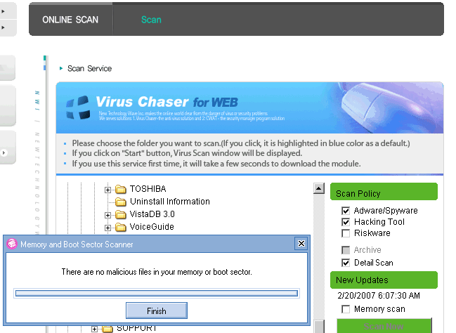

Just downloaded v5.2.5049 from our WWW and installed it onto our test computer here.
Then ran the online scan from VirusChaser's website to check both the VoiceGuide directory and the boot sector and memory as well and it came up clear. See attached screenshot.
Ran Adaware with latest update and it did not raise any problems either.

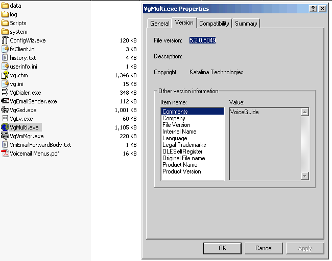

is the correct way to start the prog with the configuration wizard ?, it's v5.2.1007
Yes. The Config Wizard version is v5.2.1007.
vgmulti says 4.9.0.1
So look like you have installed v4.9 of VoiceGuide on your system (from some other source...) It's probably that download from some other download source that is the cause of your virus infection... The vgMulti.exe which comes with v5.2.5049 download is v5.2.5049 - again see attached screenshot.
