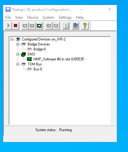

I'm testing your Voiceguide SIP HMP on Vmware Esxi 8.0 on a Windows 10 Pro.
I have installed the HMP 3.0 build548, which seems to be running, but the Voiceguide will not run.
I was able to correct this but uninstalling voiceguide and unistalling HMP 3.0 build 548 and installing HMP 3.0 build 538.
