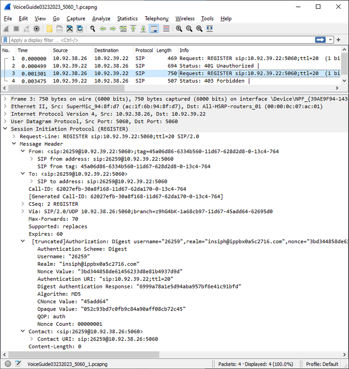

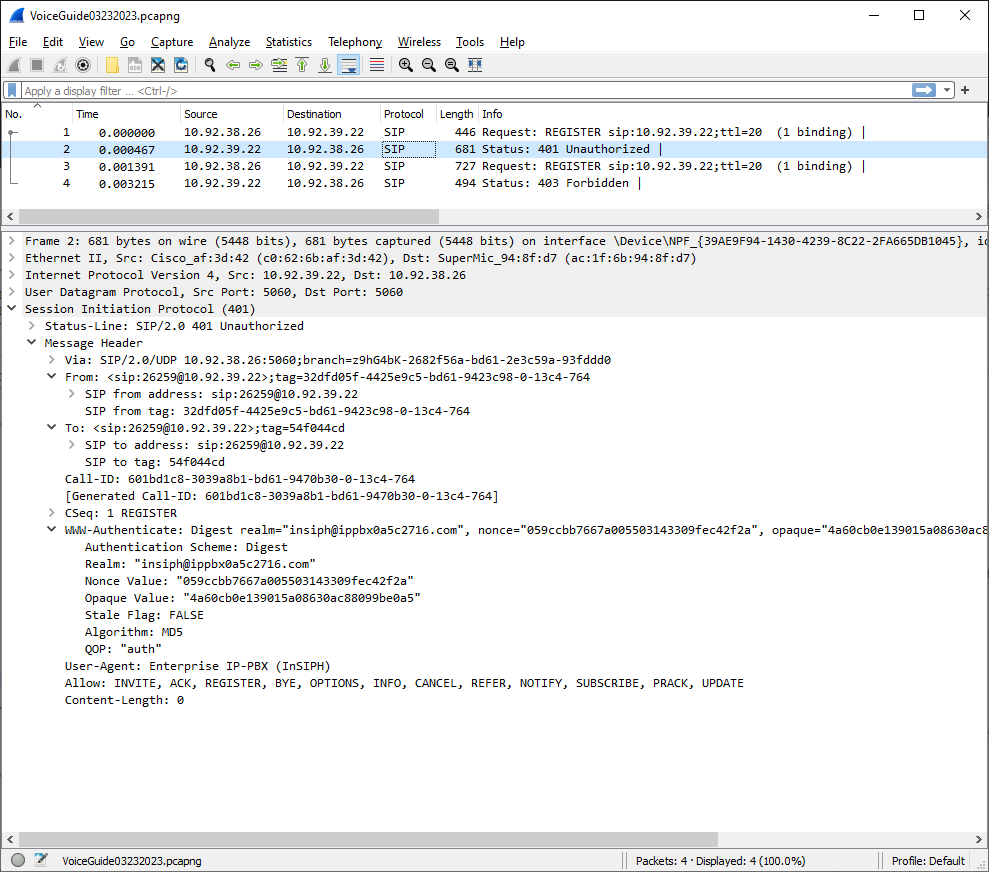

Try to register SIP extension got 401 error. I do have another system which has no issue to register SIP line to PBX. I could find the issue. Please help.
032023.zip

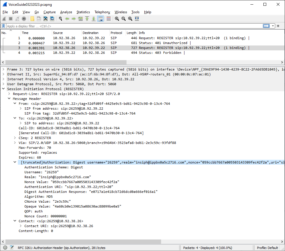

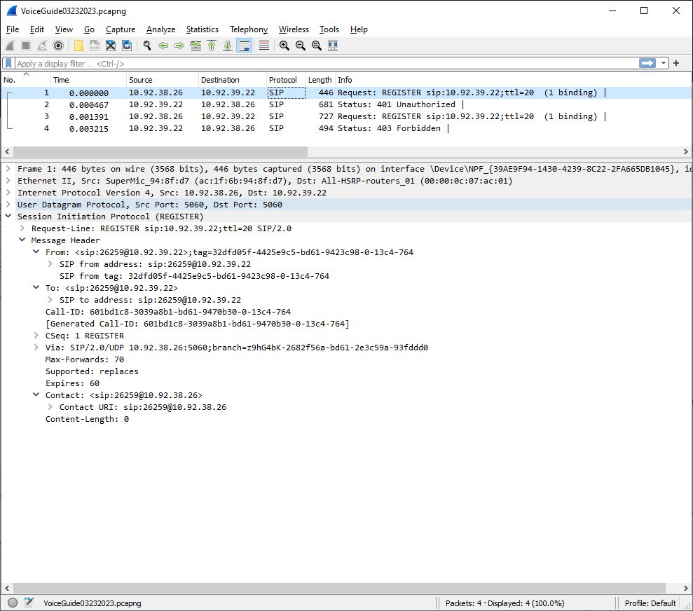

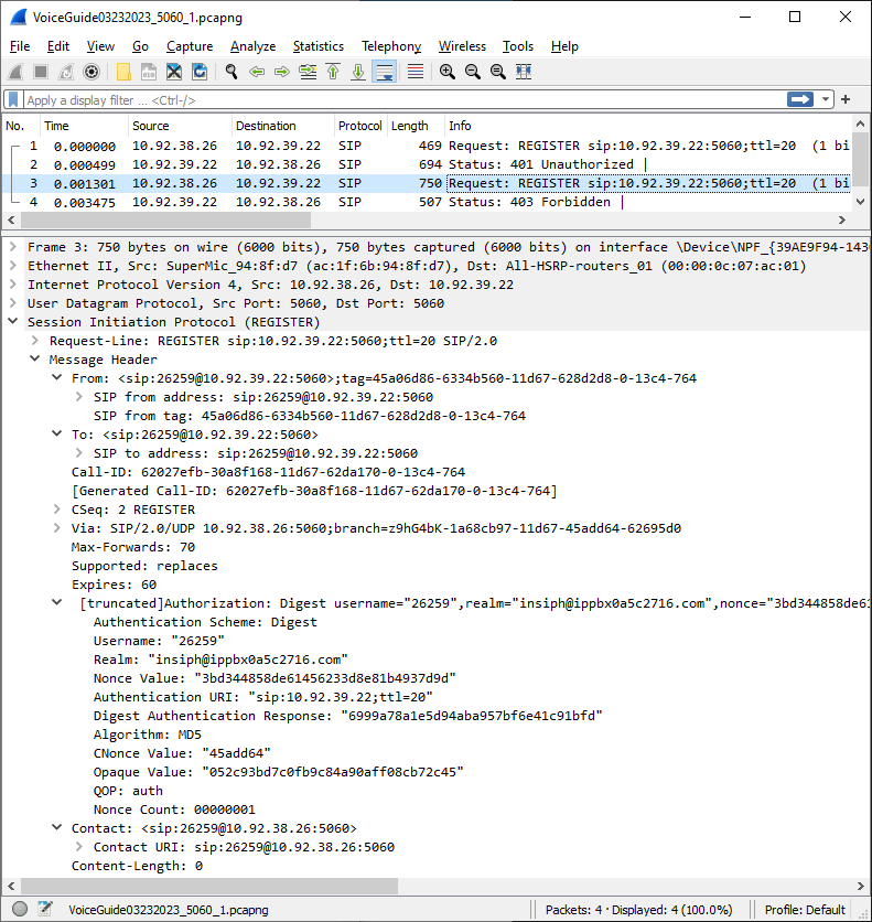

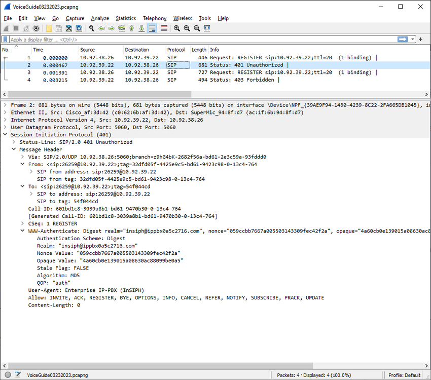

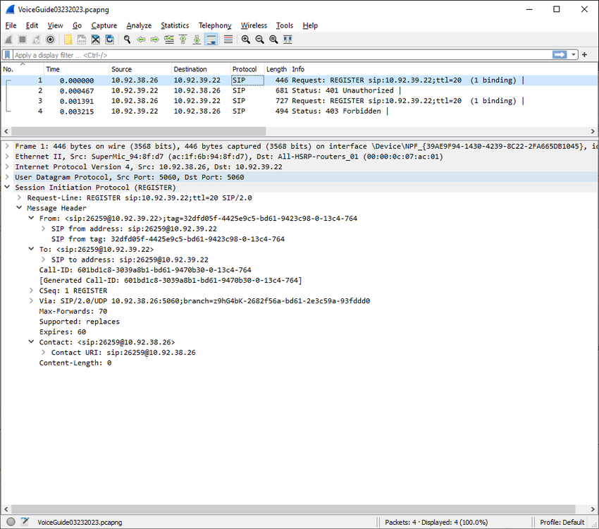

HMP/VoiceGuide response to the 401 challenge looks OK.

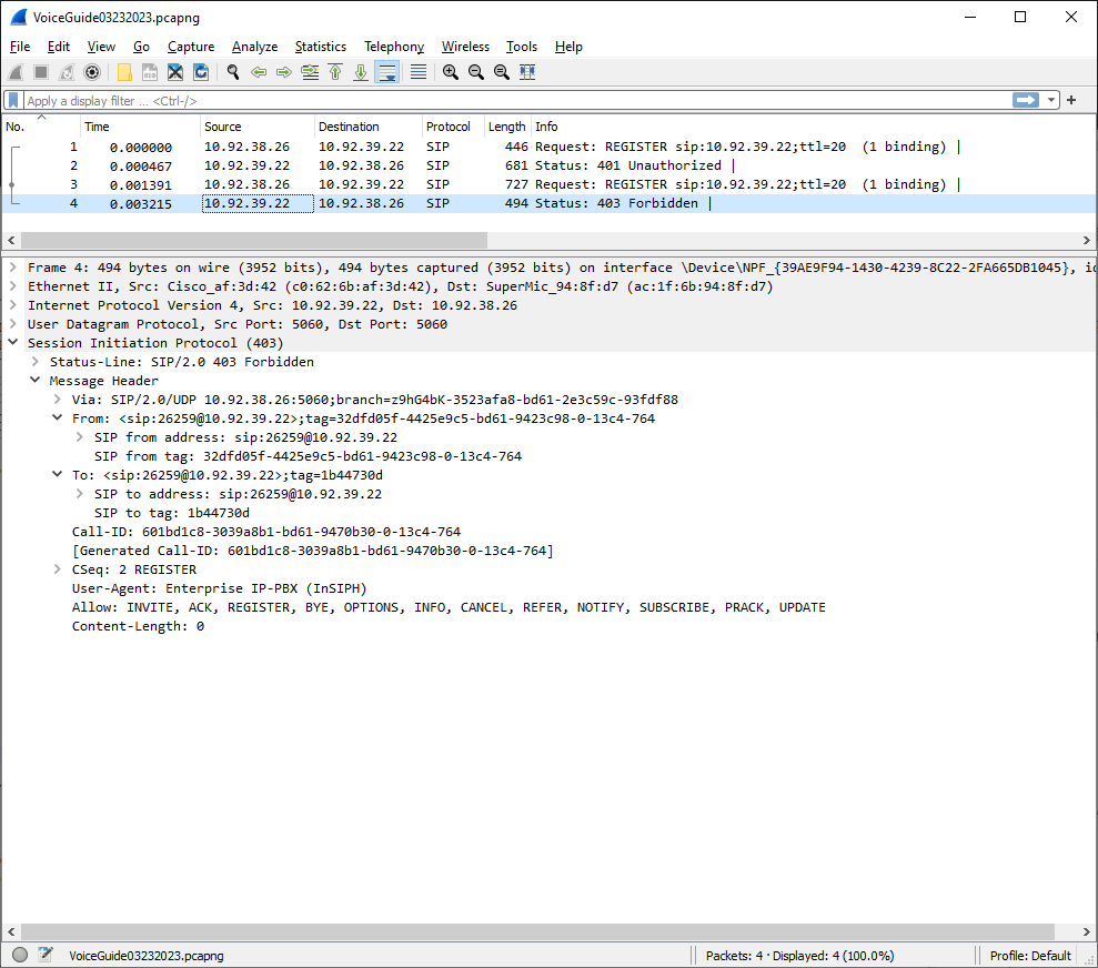

What is the device at 10.92.39.22 ? Does it have any logs that can be looked at to find out why that 10.92.39.22 device responds with a 403 Forbidden after the HMP/VoiceGuide replies to the 401-Unauthorised?
HMP response has the Authorization header containing what looks to be a valid response that includes the Digest Authentication Response.
Is the password correct?

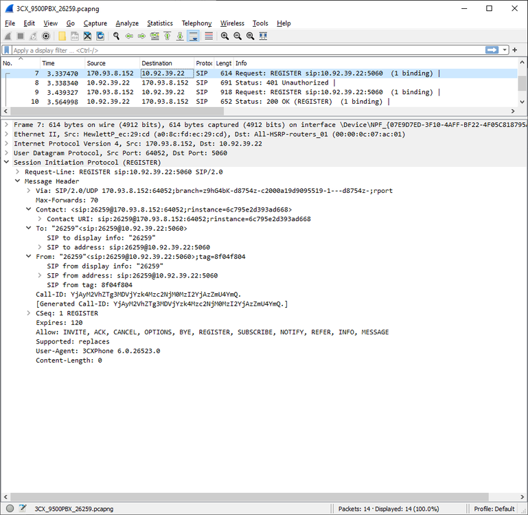

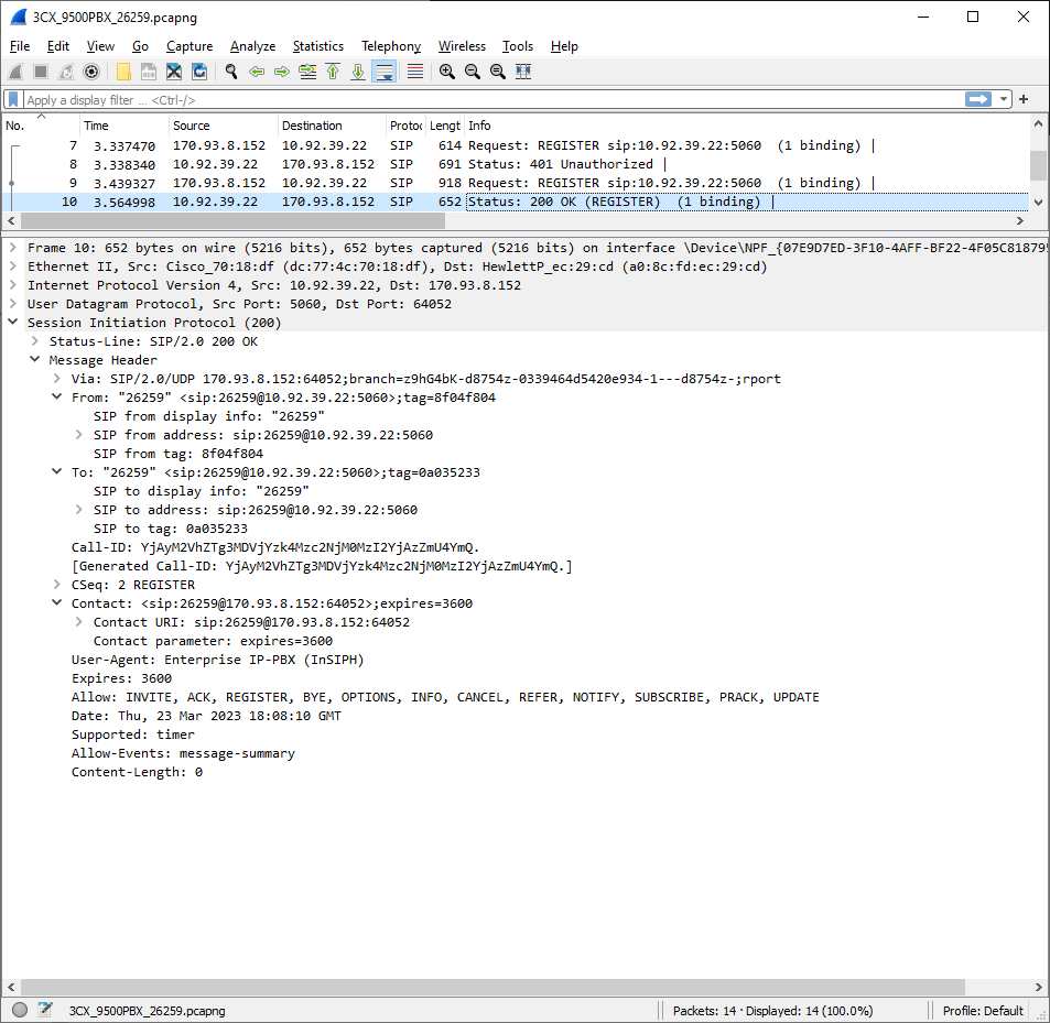

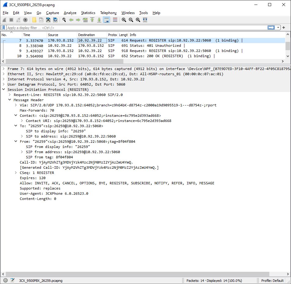

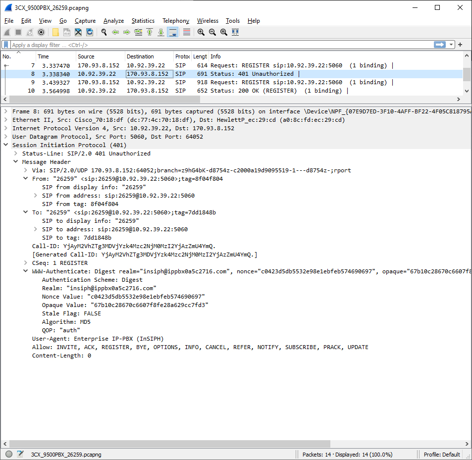

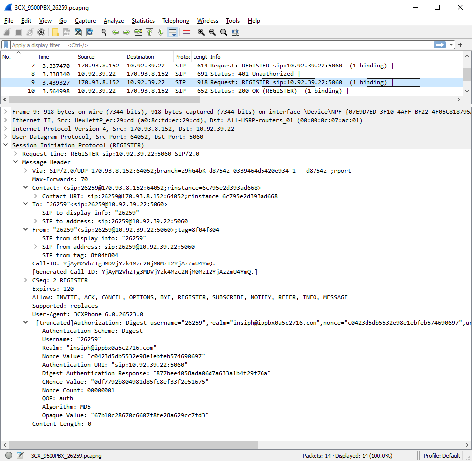

The main difference seem to be that the 3CXPhone is adding a ":5060" to the end of the IP addresses.
Would suggest adding that ":5060" suffix to all the IP addresses specified in the <VoIP_Registration> and <VoIP_Authentication> sections of VoiceGuide's Config.xml and trying the registration again.
But ultimately speaking with the administrator of this PBX would be best. They should be able to see the cause by looking at their logs. You could even be looking at some IP or User-Agent whitelists/blacklists.

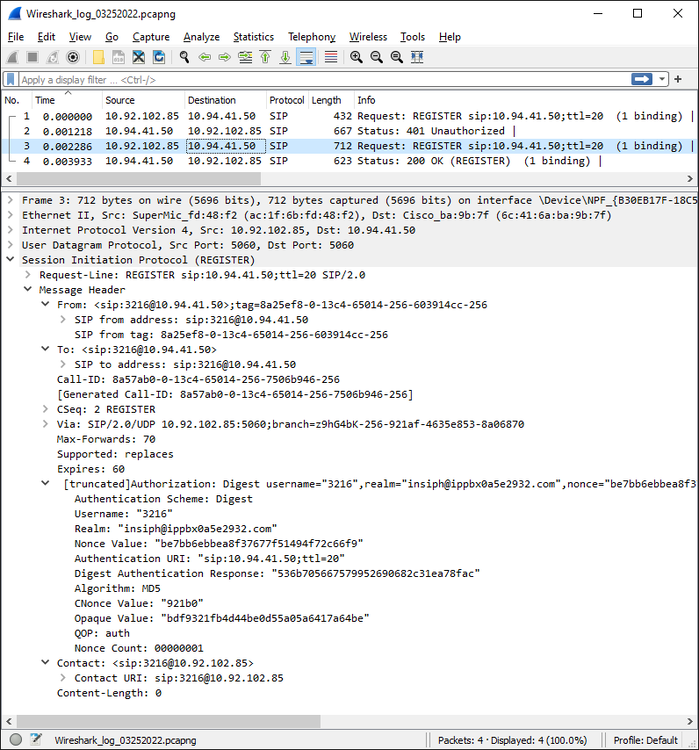

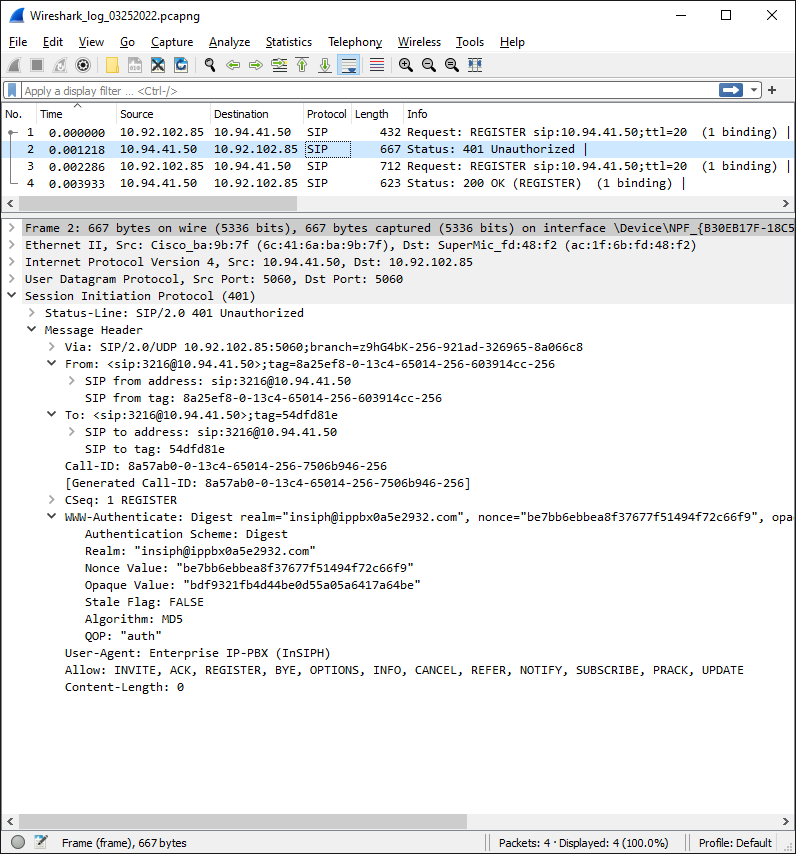

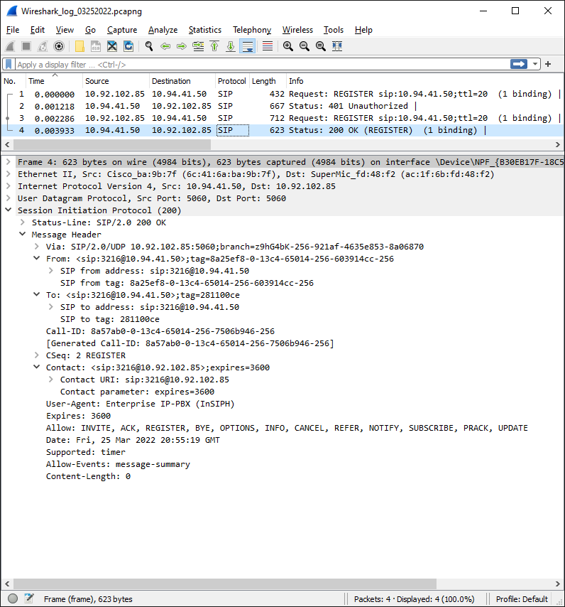

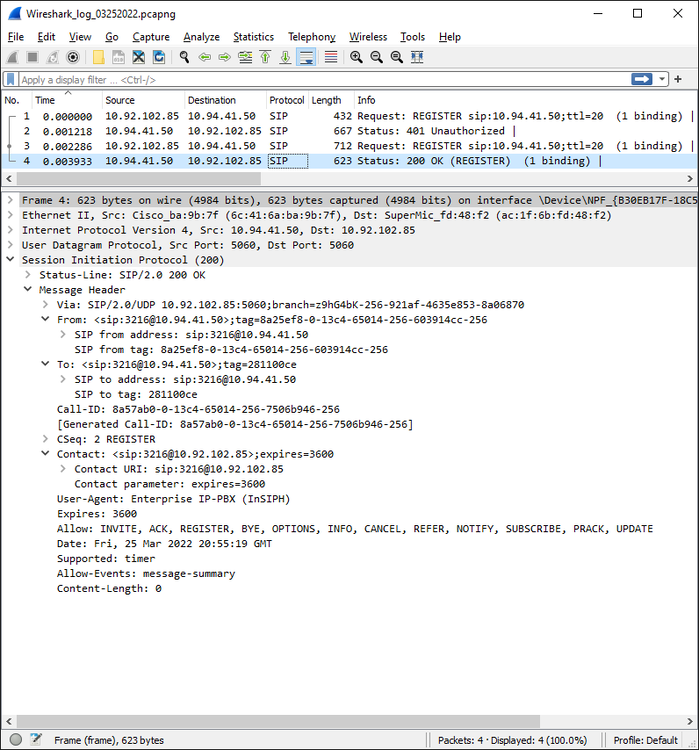

Looked at your previous post where you had the SIP registration working fine with another PBX that has same User-Agent "Enterprise IP-PBX (InSIPH)" :
https://www.voiceguide.com/forums/topic/13667-register-multiple-sip-extension
and that working registration looks exactly the same like the one that is now failing for some reason.
So again, would recommend contacting the administrator of PBX that you are currently trying to register with.

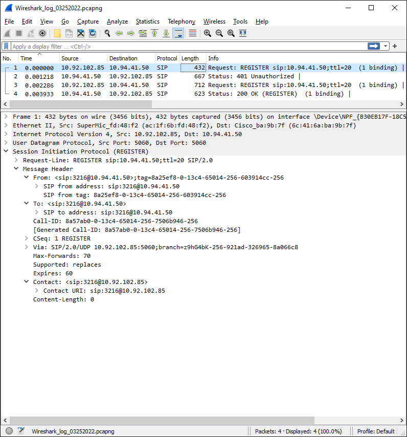

Here are screenshots of the previous successful registration for comparison:

The response to the 401 challenge now looks pretty much the same as the 3CXPhone response.
Contacting the PBX administrator would be the next step.
