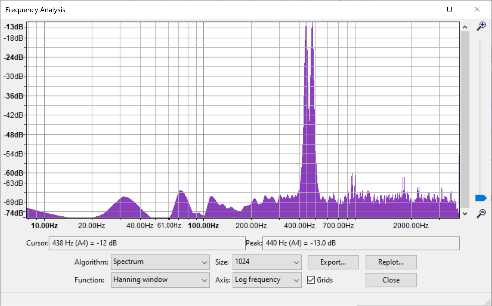

The ringback cadence is:
ON: 2 seconds
OFF: 4 seconds.
and ringback tone consists of two frequencies: 440Hz and 480Hz.
This is a pretty standard ringback and the default ringback settings that were originally used should have detected this ringback tone, so not sure why they did not...

and post traces as before.
These new settings better match the actual ringbacks, but as mentioned before, this ringback is within the envelope set by the original ringback definitions...
Is this a new card that is still under warranty? If these new settings do not work then we can start looking at Dialogic level logs.
Also, the reason why the 2nd call did not hang up by itself is because the disconnect tone was not detected.
Given the ringback on these lines is pretty standard we would expect for disconnect tone to be fairly standard as well, and detected using the default TID_DISCONNECT disconnect tone definition setting.
We would need a recording of the disconnect tone to confirm what settings should be used for the TID_DISCONNECT entry.  Please use a Record module to start recording an then just hangup and post the disconnect tone that is recorded.
The scripts can be also set to just hangup upon timeout, so inability to detect disconnect tone can be worked around, but if both the ringback an disconnect tone detections are not working then there may be something is wrong with tone detection on this card...

The Dialogic log files are in "C:\Program Files (x86)\Dialogic\log\" directory. But as Dialogic drivers did not return errors when setting the tones then it is unlikely that any errors would be shown in the Dialogic logs.
If you can post a recording of the Disconnect tone then we can confirm what settings should be used for the TID_DISCONNECT / DISCONNECT_USER_1 entries and see if the Dialogic card can detect that tone.
