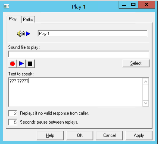

Let me know how can i set up the above scenario as well as if i placing Arabic text its showing as "????" please check the image below
Can you please try placing the Arabic text in a text file (with a ".txt" suffix) and then specifying that .txt file as the 'Sound file to be play'.
If a text file is specified in the ”Sound file to be play” text box then VoiceGuide will read in the text file and will speak (TTS) the contents of that file.
We are working on version of script designer that will allow you to use Arabic etc languages in the "Text-to-Speak" etc. text boxes.

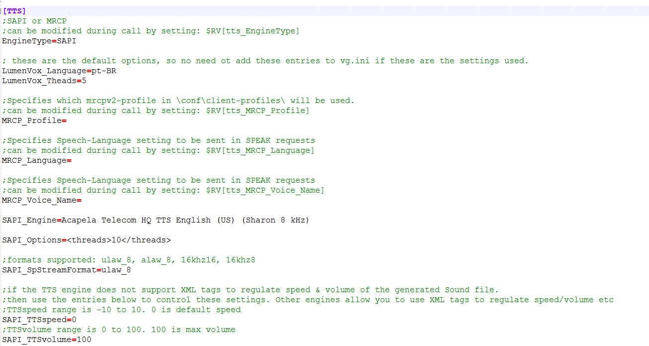

The default TTS engine to use by the system is set in VG.INI, in section [TTS]. Please see here for more information:
https://www.voiceguide.com/vghelp/source/html/config_tts.htm
If you have multiple TTS languages from same vendor then it is usually possible to switch languages by including tags in the text to indicate what language TTS should be used. Please refer to your TTS supplier's documentation.

We need to set SAPI ENGINE if using SSML TAG
The SSML tags are used in the text that is sent to the TTS engine.
The default SAPI engine would be set to one of the Acapela engines, and then the SSML tags in the text to be spoken can be used to switch between the engines.

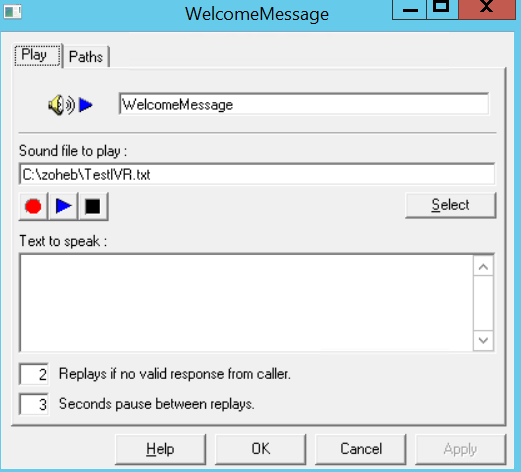

Please check the images attach.
First i have set a default SAPI TTS in VG then i place a SSML tag in text file  but its only speaking default one not the other one.
TestIVR.txt
You should contact Acapela support for confirmation on how they need the SSML tags specified.
Were any examples provided by Acapela that demonstrate SSML use?
