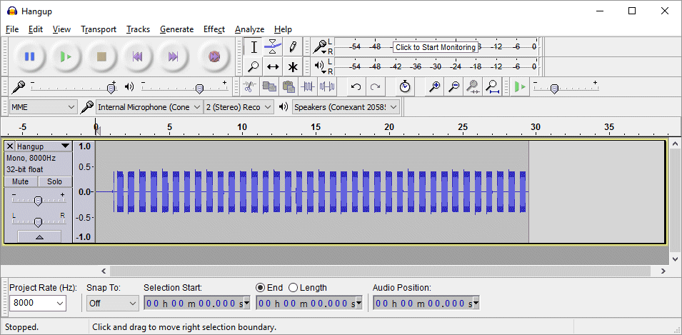

The hookflash problem has been resolved, however the system is not detecting call progress, specifically disconnect tone when the caller hangs up.
This is a default installation, using analogue extensions with callers ringing in externally. I've attached a recording of the disconnect tone when callers hang up in the menu. Can you please advise what changes we need to make to ensure the system detects caller hang up please.

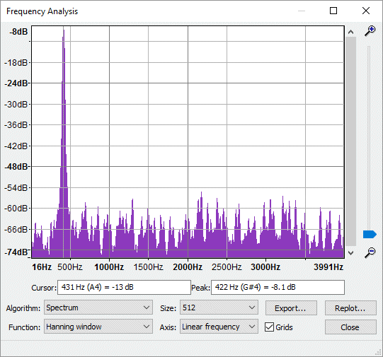

Opening attached recording file in Audacity shows that this disconnect tone is:
ON for about 380ms and then OFF (silent) for another 380ms
The ON sound is a single frequency tone, about 425Hz (see Audacity's Spectrum Plot attached)
to have Dialogic card detect this tone please edit the tone definitions in VoiceGuide's ConfigLine.xml file.
