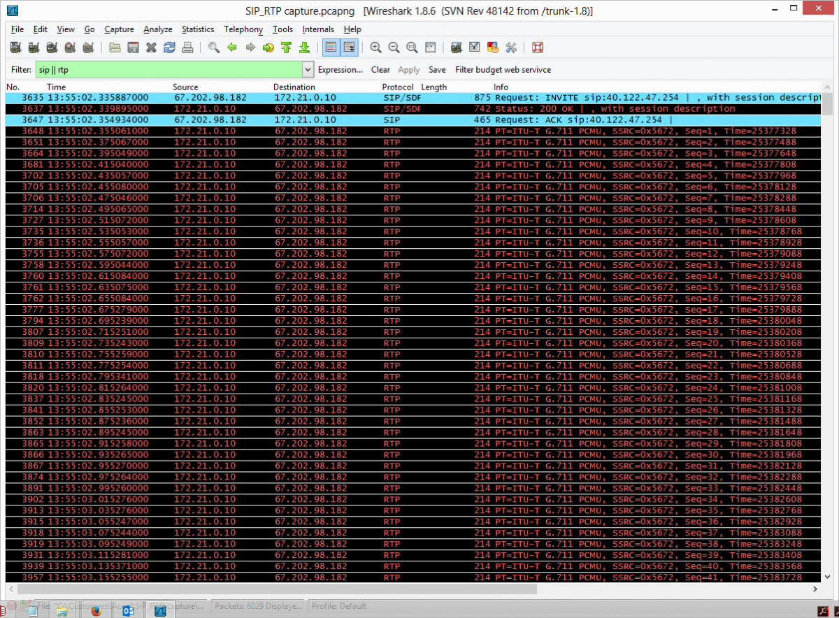

Wireshark and Voiceguide traces attached.
SIP_RTP capture.zip
After call is established the VoiceGuide system is sending RTP (voice data) back to Asterisk, but VoiceGuide is not receiving any RTP packets from Asterisk.
So caller would hear what is played by VoiceGuide, but VoiceGuide is not hearing anything at all from the caller. No sound and no RFC2833 packets.
Please see screenshot below that shows the SIP and RTP packets from the provided trace: (VoiceGuide) answered call from (Asterisk), and VoiceGuide is sending RTP data to, but there is no RTP from to
Suggest looking at Asterisk system, or the networking devices in between to ensure that there is connectivity between the systems to allow RTP packets from Asterisk to reach VoiceGuide.
We solved the issue. You were correct in that the issue lied in the Asterisk system. Our SIP provider analyzed a packet trace and noticed that the Voiceguide server was giving out its private IP address. We made the adjustment in the Asterisk SIP config to NAT=YES, and two way RTP traffic began. All seems to be well now, thank you for the assistance.
