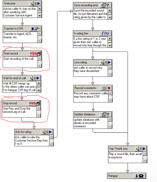

You may send me the complete flow.
As shown in the image.
Included recording blocks.
regards
ACD calls do not need the modules to start/stop recording.
ACD calls are automatically recorded by VoiceGuide into directory specified in VG.INI's [ACD] / "CallRecordDir" section. eg:
[ACD]
CallRecordDir=C:\AcdRecordings\
