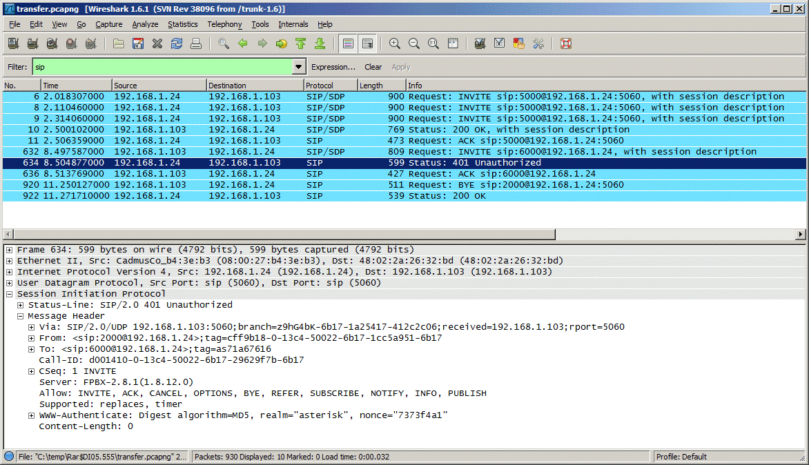

Traces show that CallerID on outgoing call was set to: 2000@192.168.1.24
The switch is rejecting the outbound call with a "401-Unauthorised", and HMP/VoiceGuide cannot authenticate 2000@192.168.1.24 as it does not have authentication information for it.
The only extensions that you have provided the authentication information for in Config.xml are the 5000@192.168.1.24 and 7000@192.168.1.24 extensions.
Suggest CallerId is set to one of the registered extensions (5000@192.168.1.24 or 7000@192.168.1.24), or add authentication information for 2000@192.168.1.24 , or set the VoIP switch to not require authentication on outgoing calls.

Screenshot of WireShark attached:
thanks I solve this problem by add authentication information for 2000@192.168.1.24
