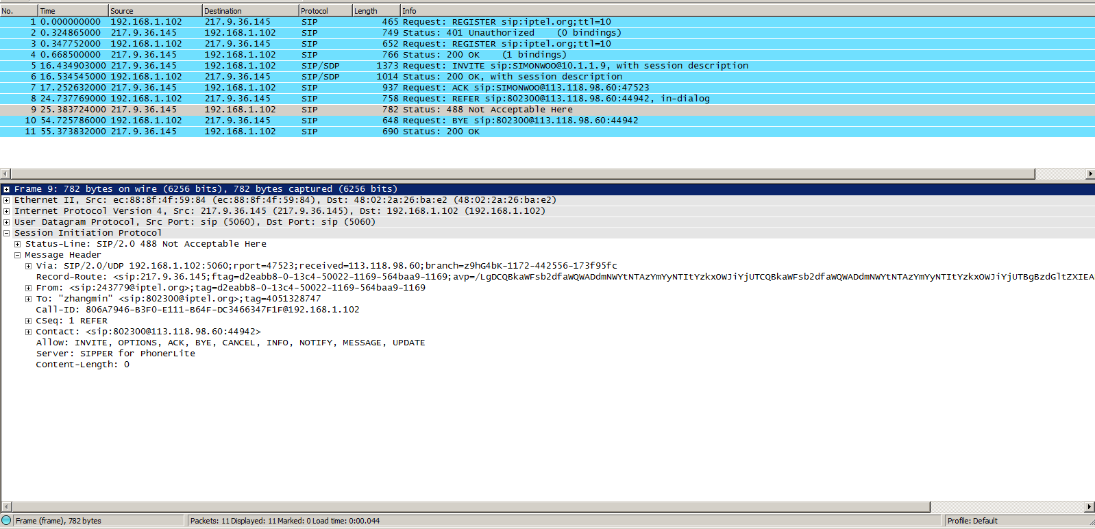

VoiceGuide traces show that the refer transfer request was rejected by your VoIP provider ( iptel.org ) with a "488 Not Acceptable Here"
See attached screenshot and WireShark trace.
