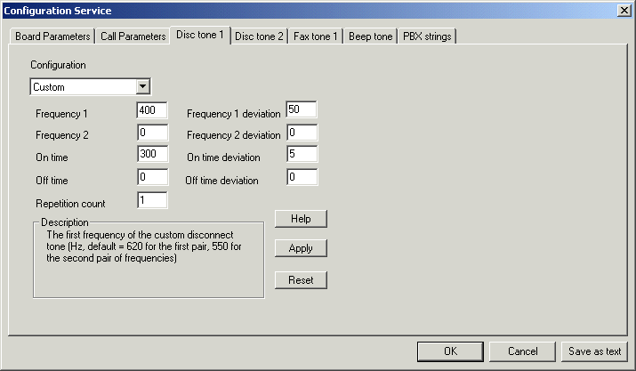

Thanks for your assistance, after numerous re-installs I have now isolated the problem. This is certainly strange in that it does not materialise until the Dialogic card is shut down and restarted (or a reboot) which takes place between each software install.
What is going wrong is I have been setting custom call parameters for the disconnect tone. In the UK with BT supplying the lines there appears to be just one continuous tone. I have measured this as 403Hz and have set Freq 1 as 403, Freq 2 as 0 then the on time as 300 and the off time as 0
These values are accepted by the configuration service and if when they are entered voiceguide is running it then seems to work and disconnect as required. However the next time the dialogic card is stopped/started or the machine is rebooted, there is a problem starting and Voiceguide quite naturally reports Lines not available.
I am now having to run with the disconnect not happening, this is not something which I can continue with given the length of the script. I attach a recording of the disconnect tone and would be very grateful for you advice as to ALL settings for Disc Tone 1 and Disc Tone 2 in the Dialogic Configuration service to disconnect the call succesfully, but also which will be acceptable to the card.

We have set the Dialogic card's disconnect tone (in the Dialogic TSP config) to the settings shown below, and have been able to stop the service (using Dialogic’s DCM) and thereafter start it again with no problems...
After service was started we checked the TSP config again and the Disconnect tone settings were kept OK...
Not too sure why changing the Disconnect tone detection parameters on your system leads to the Dialogic service not starting on your system... we have not had any other users report such problems.
The only advice I can make is to try using the SP2 version of Win2000. SR5.1.1 is only certified for SP2...
