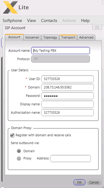

The attached screen shot is the setting information of the softphone that works for both incoming/outgoing call. (The VoIP support guy helped me establish it)
I found out the "Domain" information has port number, but I do not know where I can add that information to in VG config.xml file.
So, it might be a configuration issue?
So looks like your SIP service provider uses a port 5062 to handle the SIP registrations.
Just use the same address that you used in the softphone registration. See below.
Note that Realm entry must be set to: voip.nextiva.com
7777777 needs to be replaced with your password. (you may want to change your password now as well)
