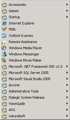

What else is installed on this system apart from Windows+Dialogic+VoiceGuide?
Not much. See attached screenshots.
Are you using any .NET development tools on this system?
As you can see, we do have .NET tools on this system but they are rarely used, and they were certainly not running any of the times that this bug occurred.
