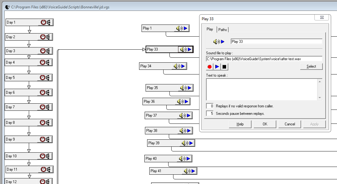

When I call into the system, the line status shows that it is going to my script design. needless to say even that matches the configuration folder as well. I get the response of a female voice that the sound file cannot be located. I am using a wav. file and doublechecked that and tried different wav. files as well. My sound files are located in the document library. I even placed them in the program files/voiceguide/scripts section. I even attempted to use the sample scripts provided and still got the "cannot find the sound file". I have checked my script layout , dates are good , time is good, the arrow goes from the date box to the play box. Please tell me how or what I need to do in order to connect the path between my recording in the script to the actual sound file.
Can you please post the script that you are using. We then better see what you are trying to do.
