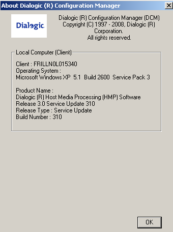

Hi Actually i'm trying to run it on myt PC. here is the HMP window that show the configurationpost-375-13185186328_thumb.png that i'm using for the test.
Is there any board required ?

No boards are required to run HMP.
Can you .ZIP up and post the Dialogic RTF logs from Dialogic's \log\ subdirectory. Maybe these will show what problems is HMP encountering.
