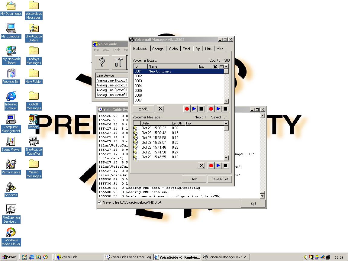

Can you please post a DIR listing of files in the VoiceGuide's \data\VmSave directory, and a screenshot of the Voicemail Manager showing the files in the 0011 or 0012 voicemail boxes.
(No need to post the vmbox xml file)
I have noticed if I delete the message (using voicemail manager) from the mailbox it is not supposed be in in this case mailbox 0073 the message is also deleted from mailbox 0001.
It looks like the for some reason the Voicemail manager on your system is not updating the message list after changing the voicemail box in the top part of the window... so that even when you think you are looking at contents of 0073 in fact you are still looking at contents of mailbox 0001..
I've just checked this on our test system and it correctly shows the messages as the voicemail boxes are changed.. so I'm not sure what this could be at this stage... If you can make a recording of what is happening on your screen and post it here that would be really good... (you can use Camtasia Studio or other similar screen recorder)
Thanks for the screen shots - it looks like the Voicemail manager is mistakenly showing messages not belonging to the currently selected voicemail box..
Are you also able to play that file from a different mailbox? We're pretty sure that this would not be possible - but if that is happening as well could you please post the trace of that as well?
We cannot reproduce this problem over here, so we've prepared a special debug version of the Voicemail Manager - please install this version (back up your VmBoxList.xml file first) in the VoiceGuide directory then just open it and view different voicemail boxes - if the some files still get listed in wrong mailboxes then please post the log file created in the VoiceGuide's \log\ subdirectory. Log file will be titled MMDDvmmgr.txt
