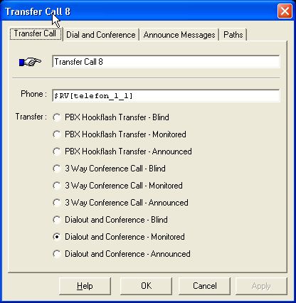

I try to transfer call, but I don't want to announced call. In both cases VG announcing call. Is that right?
I want to transfer call with MoH, recording without announcing.
Where is difference between:
DIALOUT OR CONFERENCE - MONITORED
DIALOUT OR CONFERENCE - ANNOUNCED
in both cases "Announce Message" is active
In HELP FILE I read that accepting is necessary only in announcement transfer, why VG make this in MONITORED transfer too?

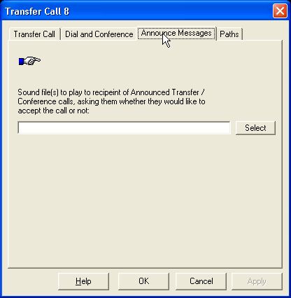

No file is selected in Announce Messages but VG is playing default announcement "press one to ..."
I don't see any reason to play announcement but it happens.
