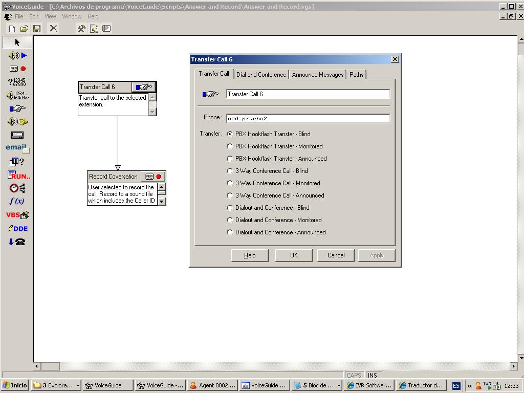

Hi I want to record the call and the name of the file $ RV_CIDNUMBER_ $ RV_CIDNAME_ $ RV_MM $ RV_DD_ $ RV_HH $ RV_NN $ RV_SS.wav but must include information on the agent.
Can you help with a variable name containing information of the agent who answered the call?

In the file vg.ini. there is no section [ACD].
I enter
[ACD]
CallRecordDir = C: \ acd
But the directory C: \ acd
is empty.
You have an example of. Vgs, to record the conversations the agents login in the acd?
Could you please post a copy of VoiceGuide's Debug Printout which captures the call connesting to agent, this will allow us to see what happened.
Debug Trace files are created in VG's \log\ subdirectory.
Once the call is transferred to ACD queue you cannot use a Record module to record the conversation of caller with agent. The ACD itself will record this when the call is actually connected to agent.
Trace shows that the call that arrived was sent to ACD queue prueba2 and was then sent to an available agent by the ACD. Call was disconnected about 16 seconds later.
