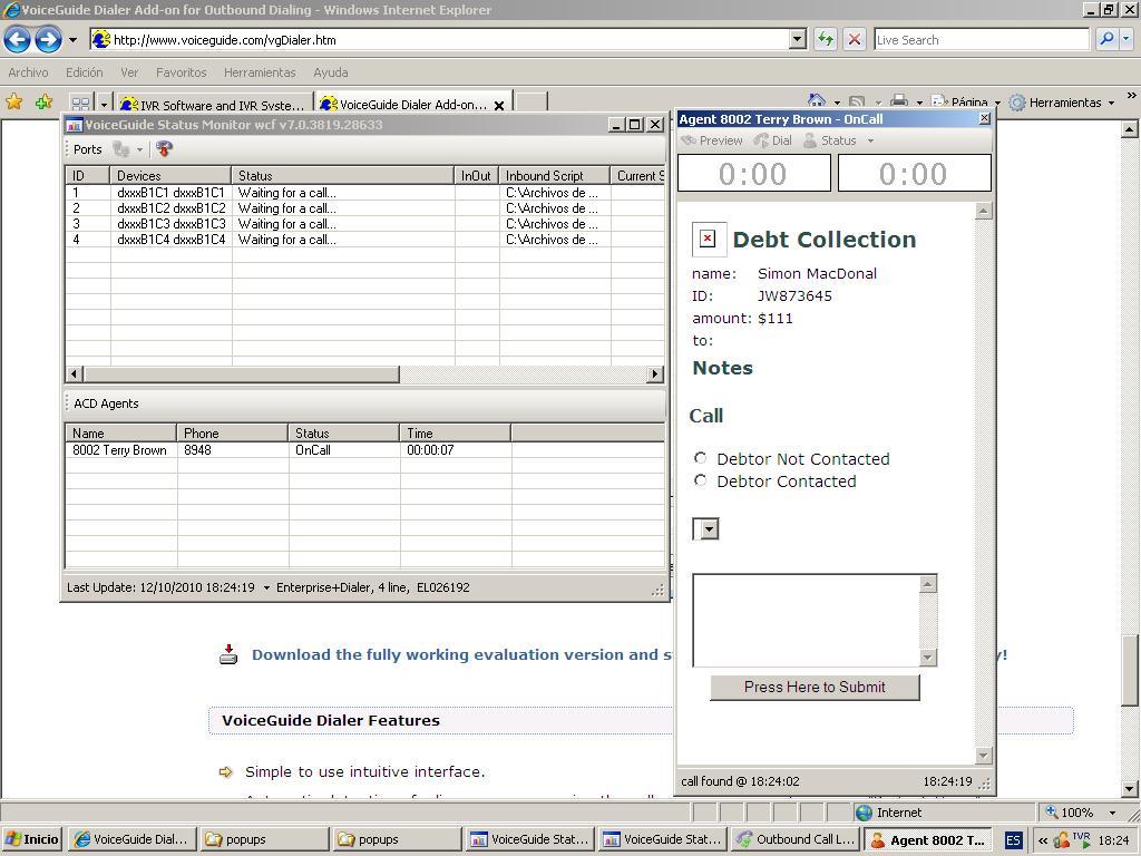

I created a campaign.
connect an agent.
I press the preview button.
But when I press the dial button does not call and freezes

And then agent requested to retrieve the next out outgoing call for a campaign that the agent is skilled at:
102555.281  1     wcfc  Dialer_GetNextCall call
102555.296  1           Dialer_GetNextCall =>
102555.406  1     ev    preview callid=1, title=prueba2, link=C:\Archivos de programa\vgAgent\popups\DebtCollection.htm, msg=, opt=
102555.406  1           AcdEvent_DoPopup_Show begin prueba2, C:\Archivos de programa\vgAgent\popups\DebtCollection.htm, , resetTimer=0,
102555.406  1           rv contains AcdAgentPopup_DisplayLink
102555.406  1           rv replace resulted in sLinkInRv=C:\Archivos de programa\vgAgent\popups\DebtCollection.htm
102555.437  1           ShowPopUp C:\Archivos de programa\vgAgent\vgAgentPopupForDisplay.htm, 0
102555.437  1           ShowPopUp - popup already visible
102555.437  1           cEXWB1.Navigate C:\Archivos de programa\vgAgent\vgAgentPopupForDisplay.htm
102555.437  1           AcdEvent_DoPopup_Show completed
102555.437  1           ThisAgentStatusSet Preview, sCalledFrom=Dialer_PresentingCallForPreview
102555.437  1     wcfc  AgentStatusSet Preview
102555.437  1           AgentStatusSet => ok
102555.937  1           Dialer_PresentingCallForPreview completed
102558.859  1     cmd   tssbDial_ButtonClick   bDialer_GetNextCall_Issued=True, bDialer_GetNextCall_Returned=True
102558.859  1           tssbDial_ButtonClick Dialer_ProceedWithRetrievedCall
102558.859  1           ThisAgentStatusSet OnCall, sCalledFrom=tssbDial_ButtonClick
102558.859  1     wcfc  AgentStatusSet OnCall
102558.859  1           AgentStatusSet => ok
102558.859  1     wcfc  Dialer_ProceedWithRetrievedCall call
102558.875  1           Dialer_ProceedWithRetrievedCall =>
102840.531  1     wcfc  AgentLogOff call
102840.546  1           AgentLogOff =>
but looks like that call never was sent to agent, and agent then logged of 3 minutes later (at 102840.531).
