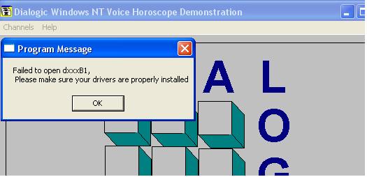

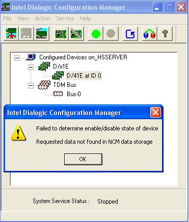

I install all but i cand start the DCM. I see the board but i don t know how to setup it. When i connect -
"NCM data storage"
I can give u user for remote it can u help me. I want to buy VG.

You would need to be able to start the Dialogic service (using DCM) and run some Dialogic test applications (eg: Voice Horoscope).
If you cannot do this then you should contact the card supplier.
