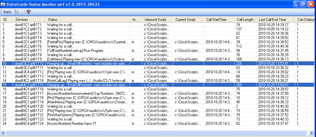

Hello again. I have followed your advice and increased timeouts, but this problem has reoccurred.
I attached a screen shot of the Status Viewer screen, where you can see the following:
1. Of the 24 lines, 11 are occupied with ongoing calls;
2. Two calls (highlighted) are stuck with the message "Hanging Up...etc." as described in the earlier post on this thread;
3. Two calls are stuck with no message (see the Last Call End Time) due to an ongoing issue we are covering in a separate thread.
On this thread we will focus on point #2. I also attached zipped up logs, plus the Dialogic logs, for the time frame in question. Please let me know what else I can do to avoid this issue.
Could you please upload the vgEngine trace extract covering time 13:50 - 14:00 for the 20th October. We need to see both the vgEngine and ktTel traces to fully see how the system is functioning.
Never Mind. The vgEngine trace is included in the .ZIP that contains the RTF logs.
Looks like in both cases the .exe called from the "OnHangup" script (IvrApp.exe) seems to stop working and ends up being forcibly closed down after a timeout of about 11 seconds. (traces show IvrApp.exe stops midway through issuing its usual list of RvGet calls. RvGet ScriptsPath is never called).
