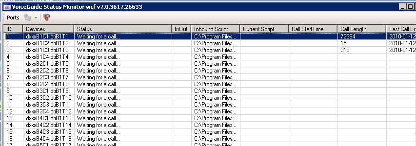

I just upgraded my VG to the newest release I have a problem. When I look into the Line Status Monitor I see calls which can last thousands of minutes. Callers dial into our system, we then dial out and connect the call. We saw this a little with the older release but never like this. I have my other VG system call this one every 10 minutes and we are getting busy signals though we are not using more than 1 line. Attached is my log file and script.

Looks like the VoiceGuide line admin task does not know the outbound call has not succeeded, and does not allow new outboind calls on that line as it thinks that there is a current call on that line.
There is in fact no connected call on that line. The mistake is with the line admin tack thinking that there is an active call.
The attached trace does not show the outbound call on port 1 that resulted in leaving that line in state where the VoiceGuide line admin task does not know the outbound call has not succeeded.
Are you able post the traces (ktTel and vgEngine) which capture the problem outbound call being made on that line?
