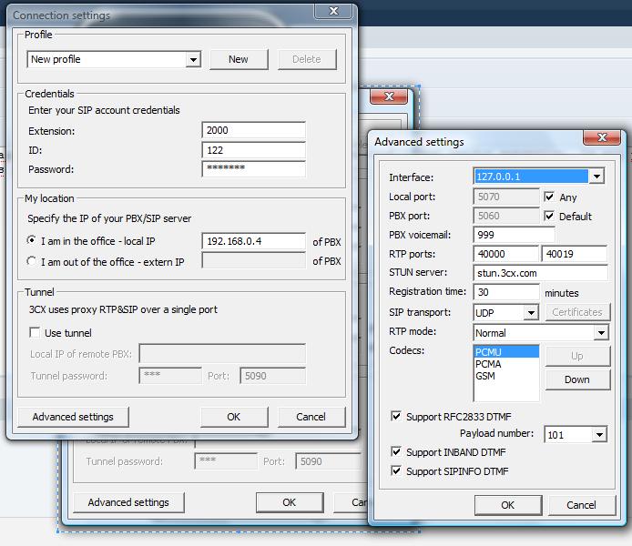

In fact I'm not fammiliar with sip techno. So maby i'm missing even the basics. I have downloaded a free SIP Softphone 3CXPhone and set random extention, Id and password (see attachement)
I have entererd the IP adress of the machine on which I have HMP. Does this sound ok ?
Please find in attachement the screen shots.

In tact what login & pwd do in need to do tthe test.?
The SIP softphone used should just send a VoIP call to a particular IP address.
It is pretty straightforward to do this using SJ Phone (see: http://www.sjlabs.com/). You just specify the IP address of the destination and press dial. The softphone used to make the call should be on a different machine to where HMP is installed.
