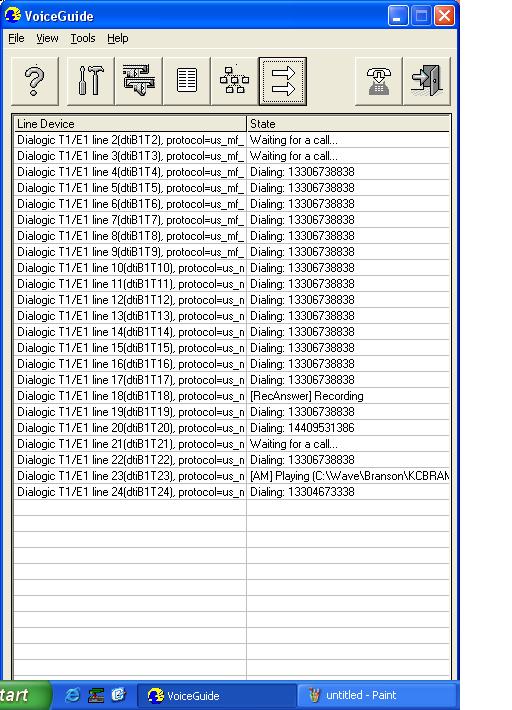

I have attached a screen shot of the AutoDialer dialing the same number many times over and over. I have verified that this number was only in the list one time.
I am able to re-create this error by loading a disconnected number. I have attached the event trace log for this situation. It only happened twice, but it's the same problem. Also notice how long it takes the system to disconnect and dial another number.
Please let me know how to resolve this.
