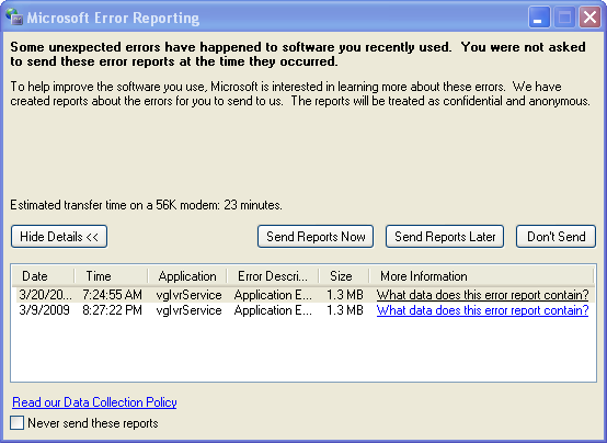

Here is the error in the event log that may point to the issue...
Event Type: Error
Event Source: .NET Runtime 2.0 Error Reporting
Event Category: None
Event ID: 1000
Date: 3/20/2009
Time: 7:20:21 AM
User: N/A
Computer: EARTH
Description:
Faulting application vgivrservice.exe, version 7.0.3.0, stamp 49b546c4, faulting module mscorwks.dll, version 2.0.50727.3082, stamp 492b82c1, debug? 0, fault address 0x00025155.
Data:
0000: 41 00 70 00 70 00 6c 00 A.p.p.l.
0008: 69 00 63 00 61 00 74 00 i.c.a.t.
0010: 69 00 6f 00 6e 00 20 00 i.o.n. .
0018: 46 00 61 00 69 00 6c 00 F.a.i.l.
0020: 75 00 72 00 65 00 20 00 u.r.e. .
0028: 20 00 76 00 67 00 69 00 .v.g.i.
0030: 76 00 72 00 73 00 65 00 v.r.s.e.
0038: 72 00 76 00 69 00 63 00 r.v.i.c.
0040: 65 00 2e 00 65 00 78 00 e...e.x.
0048: 65 00 20 00 37 00 2e 00 e. .7...
0050: 30 00 2e 00 33 00 2e 00 0...3...
0058: 30 00 20 00 34 00 39 00 0. .4.9.
0060: 62 00 35 00 34 00 36 00 b.5.4.6.
0068: 63 00 34 00 20 00 69 00 c.4. .i.
0070: 6e 00 20 00 6d 00 73 00 n. .m.s.
0078: 63 00 6f 00 72 00 77 00 c.o.r.w.
0080: 6b 00 73 00 2e 00 64 00 k.s...d.
0088: 6c 00 6c 00 20 00 32 00 l.l. .2.
0090: 2e 00 30 00 2e 00 35 00 ..0...5.
0098: 30 00 37 00 32 00 37 00 0.7.2.7.
00a0: 2e 00 33 00 30 00 38 00 ..3.0.8.
00a8: 32 00 20 00 34 00 39 00 2. .4.9.
00b0: 32 00 62 00 38 00 32 00 2.b.8.2.
00b8: 63 00 31 00 20 00 66 00 c.1. .f.
00c0: 44 00 65 00 62 00 75 00 D.e.b.u.
00c8: 67 00 20 00 30 00 20 00 g. .0. .
00d0: 61 00 74 00 20 00 6f 00 a.t. .o.
00d8: 66 00 66 00 73 00 65 00 f.f.s.e.
00e0: 74 00 20 00 30 00 30 00 t. .0.0.
00e8: 30 00 32 00 35 00 31 00 0.2.5.1.
00f0: 35 00 35 00 0d 00 0a 00 5.5.....
