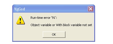

Hi
I get strange behaviour this after noon.
Making outgoing calls I saw that my CallQue database shows always the same number of entries. When looking at the line status panel I saw that calls where juste starting and system jumps to next number (log : 0317_1832_vgEngine1.zip) Call where not placed.
Then I have re-started the service and when looking at the line status panel again It shows "Not conneceted" when trying to connect manualy, it does not connect and nothing happens anymore (log 0317_1832_vgEngine2.zip)
It seems that I need to restard the complete machine to make the service run again.
tks you for yout help
