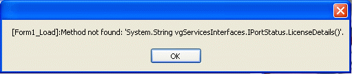

The error message which you posted a screenshot of is from the Line Status Viewer app, correct?
Did VoiceGuide itself start? Please post VoiceGuide traces which show VoiceGuide startup on this system. The traces will show which DLLs VoiceGuide and cannot find.
The error shown in screenshot can occur if you are using a different version of the Line Status monitor then the one that is shipped with the version of VoiceGuide running on your system. Would recommend that you uninstall VoiceGuide backup and config files and scripts first) and then delete the VoiceGuide directory and then re-install VoiceGuide. Then please post the traces capturing the startup.
You are correct. It must have been using the wrong Line Status Viewer. I reinstalled and made sure to use the new one. It seems to be working fine.
