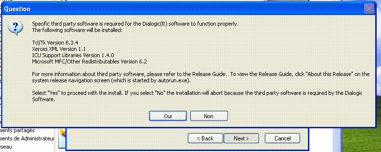

1. When Installing SR6.0 I have an error message (please see attachement AT1) are these third party software mandatory ?

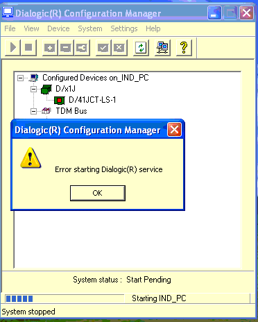

2. I went through the error messages and came to finish the DCM installation but DCM does not detect the board (windows has detected the board).
3. When I'm adding the board manually, the system does not start (attachement AT2)
Would you please help me in these last installation steps (I know that this is more dialogic support but i'm now used to your reactivity :-)
