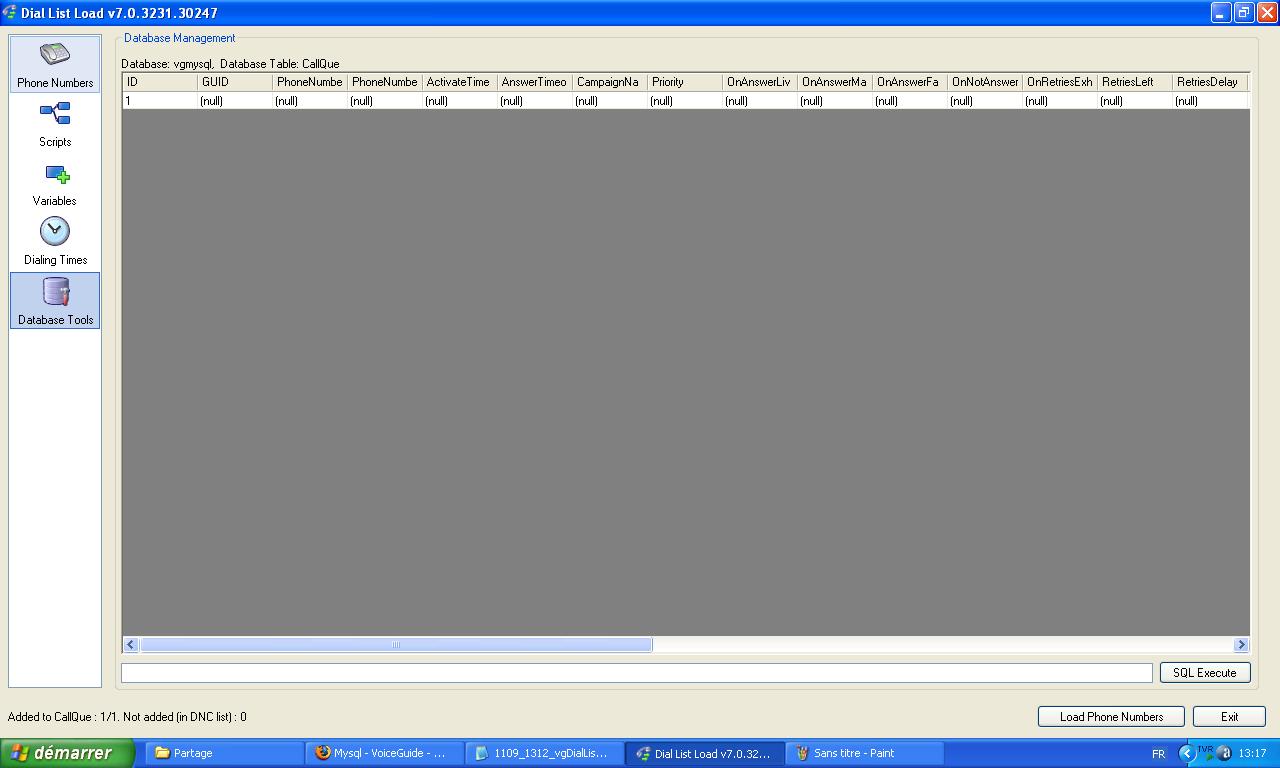

I have succededd connectiong to mysql. The point now is:
- When I'm uploading entries using Data list Loader, I have NULL values in all fields.
- I have set <OutDialQue_PortToUse_LinkField> to Disable in the <Dalier> section and it seems that PortTOuse table is populated anyway. Please advise

Trace shows that you are using an old version MySQL ADO.NET provider: v5.0.9.0
You need to use v5.2.3. See instructions in VoiceGuide Help file.
After you update to the right version of the MySQL ADO.NET provider you need to let the new VoiceGuide version create the tables in MySQL. ie: You need to drop any tables created by the previous versions of VoiceGuide/provider and let this new version create it's own tables.
Do not use the <OutDialQue_PortToUse_LinkField> initially. It should work without the <OutDialQue_PortToUse_LinkField> being set in Config.xml.

Hi I have done tests. No success,
-When adding entries in CallQue with VG call loarder all fields are set to NULL
- When adding manually entries using sql commands, the entry appear in the VG call loader but outbound call are not made . It seems that [ActivateTime] does not have the right format.
Please find logs in attachement

an idea..
I have seen in the logs in this request :
SELECT CallQue.ID, CallQue.GUID, CallQue.PhoneNumber, CallQue.PhoneNumberPrefix, CallQue.ActivateTime, CallQue.CampaignName, CallQue.Priority, CallQue.OnAnswerLive, CallQue.OnAnswerMachine, CallQue.OnAnswerFax, CallQue.OnNotAnswered, CallQue.OnRetriesExhausted, CallQue.AnswerTimeout, CallQue.RetriesLeft, CallQue.RetriesDelay, CallQue.RV, CallQue.CallOptions, CallQue.EscalationCalls FROM CallQue WHERE ( (CallQue.ActivateTime <= @dateNow) AND ((CallQue.TimeStart_Mon <= 1138) AND (CallQue.TimeStop_Mon > 1138)) ) LIMIT 1;]
That you are using @dateNow, thiss returns nothing. When replacing @dateNow by Now(), it returns entries...
Tkx

The Dial List Loader trace shows that the call you loaded had a call window which starts at 8PM on most days, and current time on machine is 9AM...
GOT IT!!!!!
Indeed, I got French date settings. But on my system it did not work because of the Mysql connector version. That was the probleme for call loading.
