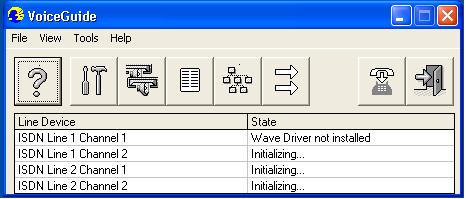

Traces show that the Eicon card's TAPI driver cannot provide a handle to the Wave driver. VoiceGuide then errors out as it cannot proceed if the Wave driver is unavailable.
091451.640 tapic lineOpen(0x800003ff, 8, 0x22e774, 0x10004, 0, 0x22e768, 0x4, LINEMEDIAMODE_INTERACTIVEVOICE | LINEMEDIAMODE_AUTOMATEDVOICE, 0)
091451.656 tapic lineGetID(0x103bb, 0, 0, 0x1, 0x8910020, wave/in) LINECALLSELECT_LINE hLineInfo
091451.656 tapic lineGetID(0x103bb, 0, 0, 0x1, 0x8910020, wave/in) => 0x8000004b LINEERR_RESOURCEUNAVAIL

I delete Diva Service Provider from list and use ComISDN Service Provider (install from Comisdn_TAPI_20071212_FV_CAPI_C_3.2.56.zip). Set up wizzard with ISDN lines and when I start VG still is the same info (print screen attached).
